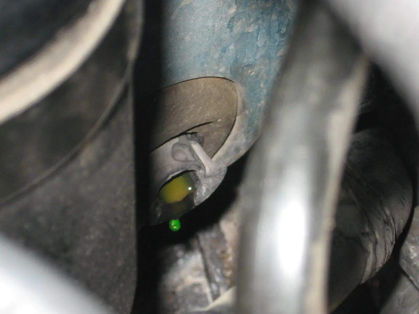

What is this and why is it leaking coolant from it? Isn't something for the a/c?
how can i stop the coolant from leaking? and the a/c is off

The part in the picture is the AC drain line for the passenger compartment. The fact that coolant is leaking from it means that the heater core is leaking.
To fix, there are two choices.
Replacement of the heater core will require the dash to be removed. This can be done by a DIY'er. I won't lie. It's a big job. IMO, the Chilton's manual has the best write up on how to do the work. A good service manual is a MUST.
Loop the heater lines. This will bypass the heater core and stop the leak. However, there won't be any heat in the passenger compartment.
Do not plug the heater lines. Loop them. The flow of coolant through the heater lines is necessary for the water pump to maintain it's prime.
