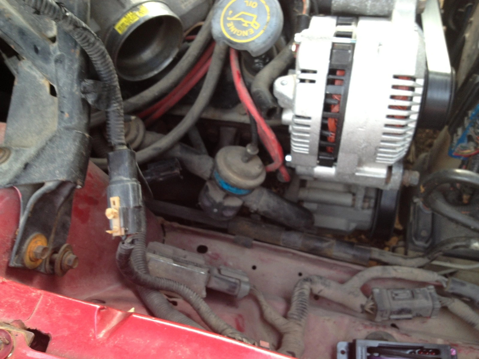

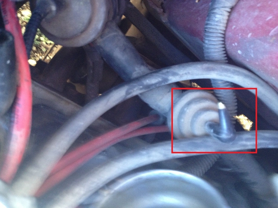

What is this?
Could be unrelated since I never generated the 81, 84, or 44 94 codes. So I guess it's functioning some what:p
Just was pointing out that the vacuum line on top was missing.
This is on a 94-95, right? Two-digit codes are for Fox III's.
I thought you said you'd had 311 and 314 codes in the past. Those are AIR codes. Without a vacuum signal, a diverter can't function dynamically.
Oh woops (I was reading from old threads, did not know that, learn something new every day).
Yeah 94 to 95:P
I really need to pull codes again, but yes 311 and 314. Where is this suppose to be connected to?

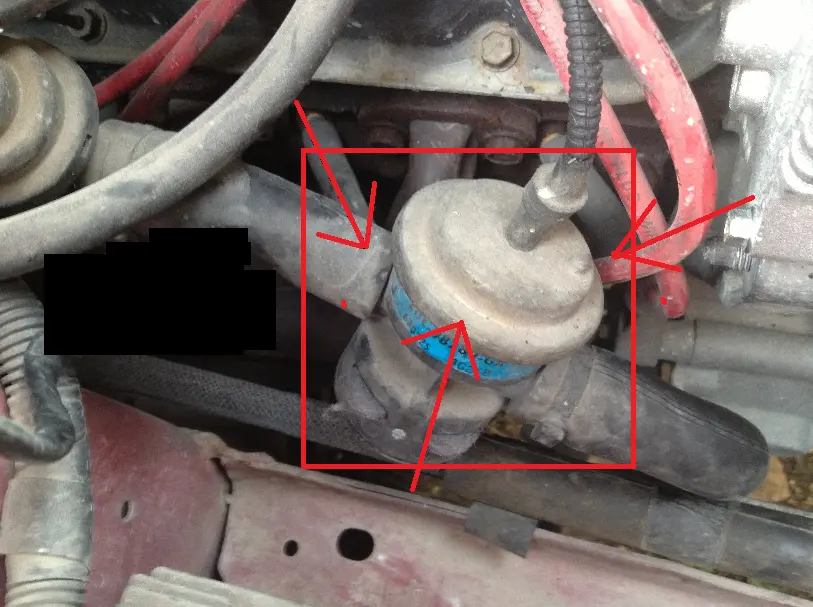

For info's sake or in case you need to trace lines or delve further into it:
The third pic (<- click) might help. You'll have to pull the fender liner. Look at those two little cuties sitting side by side (TAB and TAD; AKA AIR 1 and AIR 2). You can see the harness of plastic vac lines leaving those solenoids, heading towards the front of the car. They snake up past the inlet pipe and to where you see the connection and breaks in the engine bay.
