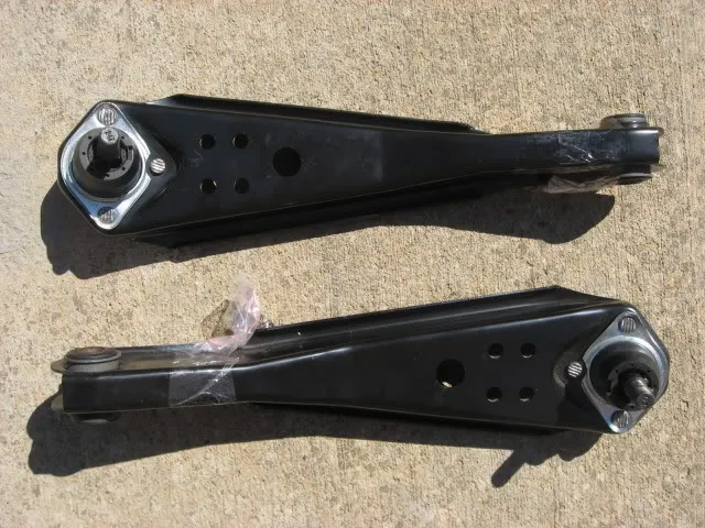

67rcks said:
Interested only in OE-like arms. No TCP GW etc.
Here ya go:

My (early) '67 original LCA were riveted in. I tried repops but the bushing slid in the mount causing metal/metal rubbing in the mount. I bought the Moogs from Va Mustangs for $50ea. which was cheaper than the repops, quality and I had the bushings tack welded just in case.

All 64-73 ball joints were riveted.
