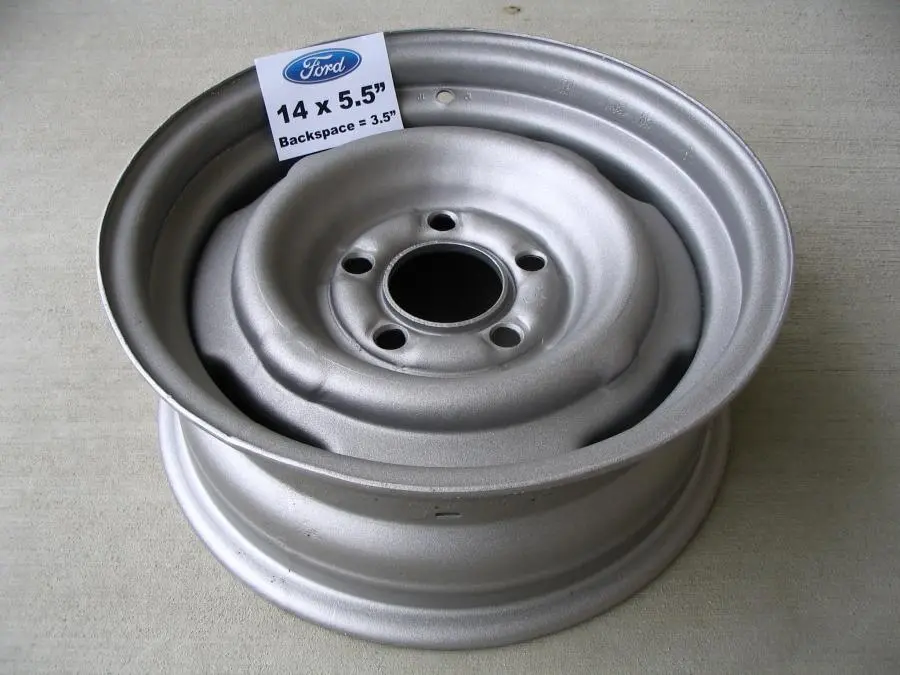

These:

This is the 68 styled steel wheel. It was available with a chrome center, argent center, or reflective argent center.
The Magnum 500 was offered on the 66 GT350, the 69-70 BOSS, and 71-72 Mustang only. The 69 Mustang and mach1 used the same wheel as 68. In 1970, the wheel changed to a 5-hole design, but used the same hubcap.
