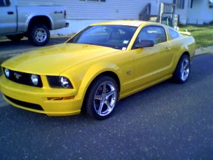

03 saleen wheels on the 05 gt (18x9/18x10's)
