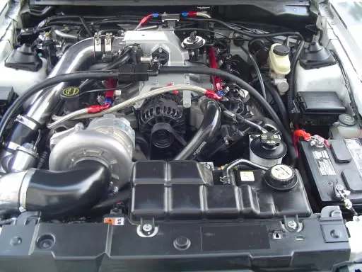

As for terminals ... you could get some like these:
They are gold plated and work excellent. They are like 25 bucks for both of em' and super easy to put on. You just cut off the old pieces of junk right where the wire connects and then strip it down just a little, then slide the wire into the new connectors and two screws tighten down to hold it on. And on the positive terminal, there are hex screws that hold the wires in (even easier) and plus it has like 4 slots in case you have speakers or other accessories that need to be connected to the positive terminal.
Just a thought ... I got them at like Autozone I think.

DTNODYA said:
+1
After you do this and it dries, put some vaseline on the terminals and it will keep the corrosion from coming back for a long time.
Those are nice. :nice:
My negative connector was so rusty that I couldn't turn the nut. I ran out and bought a replacement for it for the short term. It's brass and went on easy. My positive connector looks fine for now. I'm going to look around and see what I can find and then buy a red top Optima.

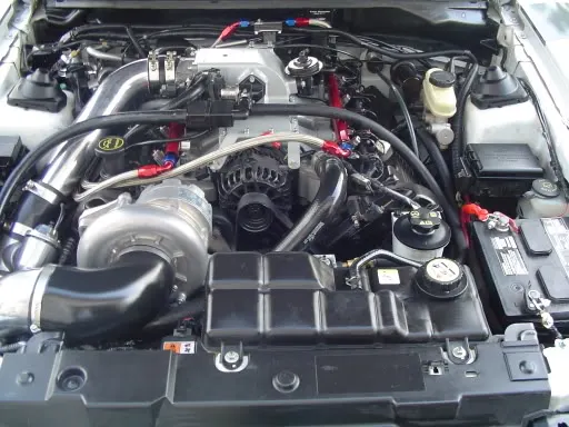

White Stang said:
I got these quick release ones from my bike seat. :rolleyes: J/k:
I actually picked them up at Pepboys and they're great for me since I'm always working on the car.
Where did you buy them from? Got any closeups?
Nice SC! :nice:

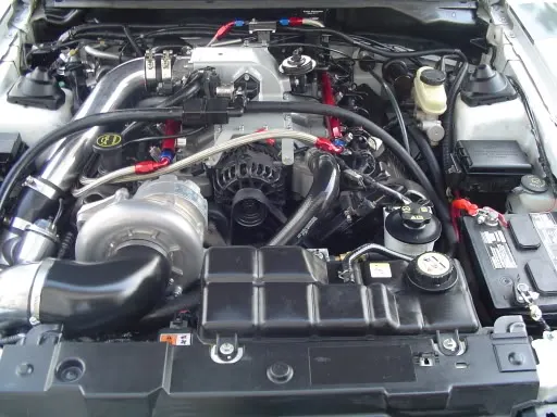

Here's a pic I found of how I did my trucks terminals ... used a gold connector for the positive and a quick disconnect (cheap-o, but works great) for the negative terminal.
Yeah, I think I am going to get an Optima sometime soon also. My car eats normal batteries for some reason. :shrug:
