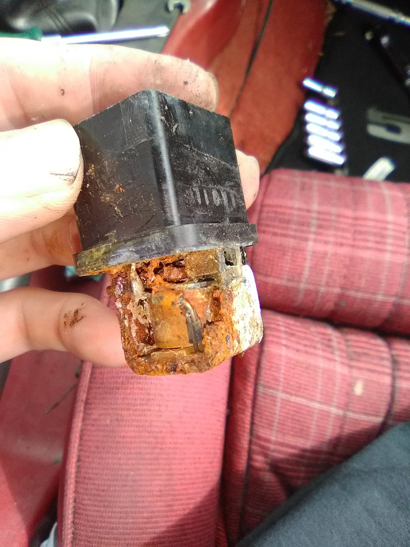

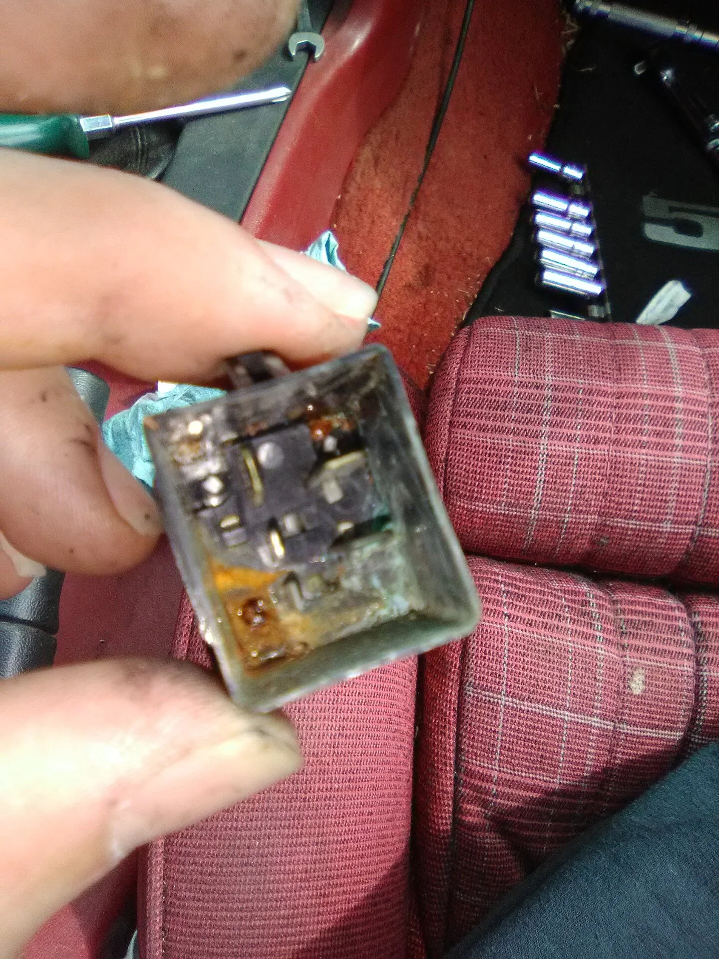

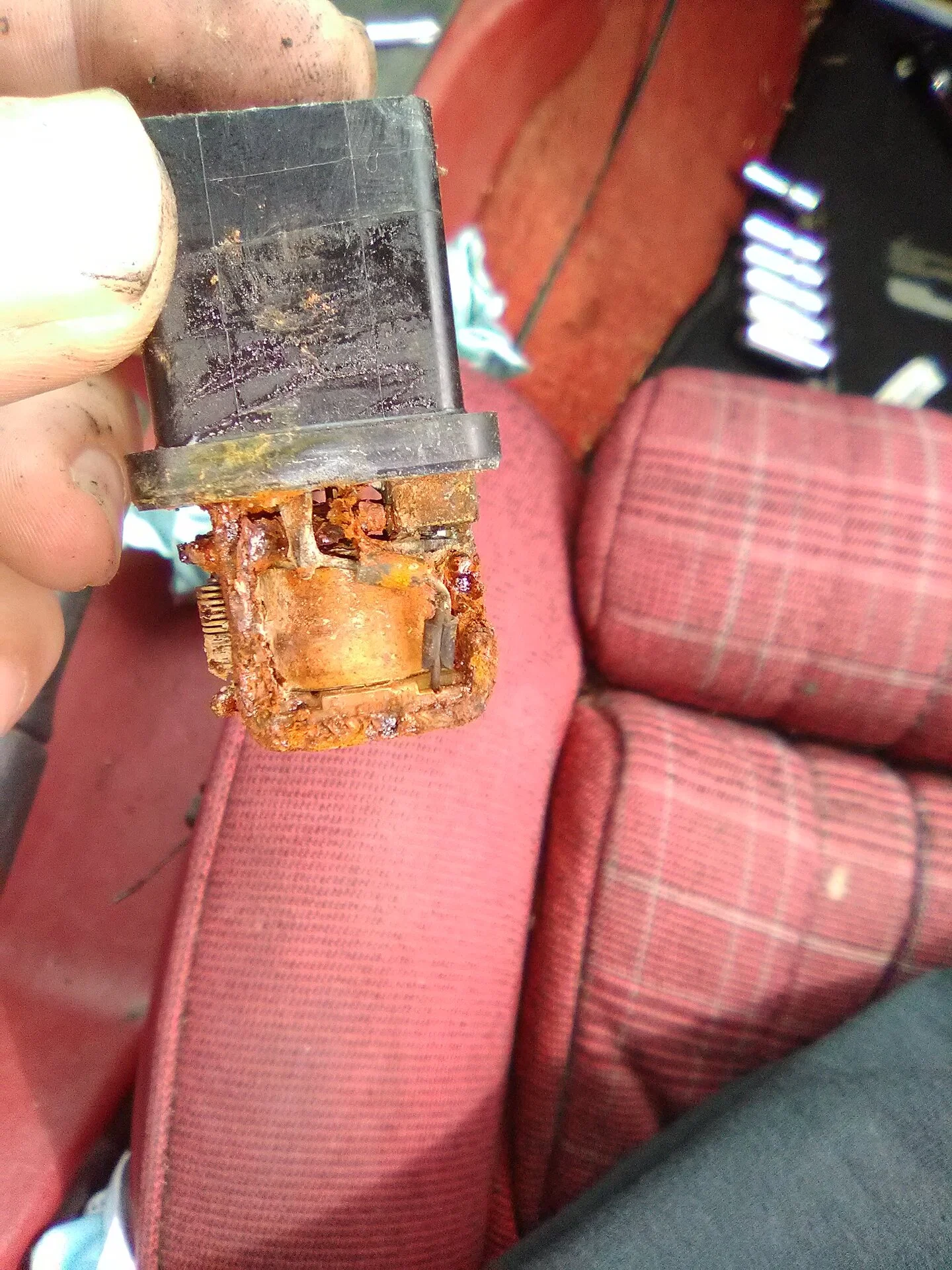

I tested most all that. I know they have nothing to with each other. But on this car, i think its a timing thing. It appears it was flooded. Had to be. It seems like a chain reaction thing. I assume more issues will rise.
Look at this EEC/PCM relay. They are 1 in the same right? Lol this thing is tuuhrashed! Gotta be it.
Also not the factory PCM relay since it has 5 prong. Factory was 4. Or this is not the PCM relay. Looks like it is and in right area.

Where did you find that rusted relay? If it was under the driver’s seat most years, it should be the fuel pump relay. It does look like it was under water.

Up by the computer. Once i pulled it. Has the same notch/look. Was hanging down, but above the computer, not attached to factory spot that is apparently hard to get to. Telling me someone has changed it before also. Got one coming in tomorrow.

wow was that car in hurricane Katrina? are there any other signs of rust/corrosion to the wiring or electrical system?

Might of been. Bought it from corpus christi area. Had grass and coming from under the wing on hatch everytime i wash it for last year. Lol im like how is this possible.
But at sametime, i dont see corrosion on a much other stuff. All the wiring looks to be in fair condition for being 30yrs old. Computer looks good. Very light bit of browning on top of plastic holder frame from heat.
That is the eec relay then. And that does not look like it was working at all. Check the wiring and make sure they didn't rig it up to bypass the relay.

Right on. Connector and wires attached look good.
