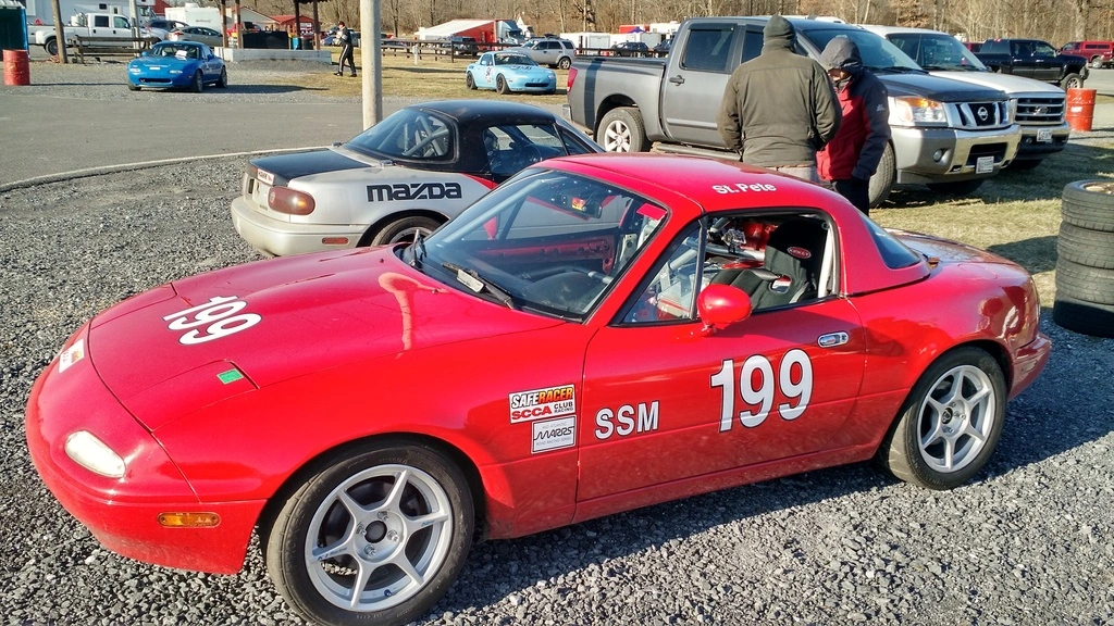

I started taking this car to the track bone stock, cheap autozone brake pads and all. Over the last 10 years, it's gone through 4 iterations from stock, to trackable street, to streetable track, to full race.
