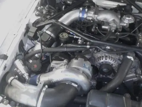

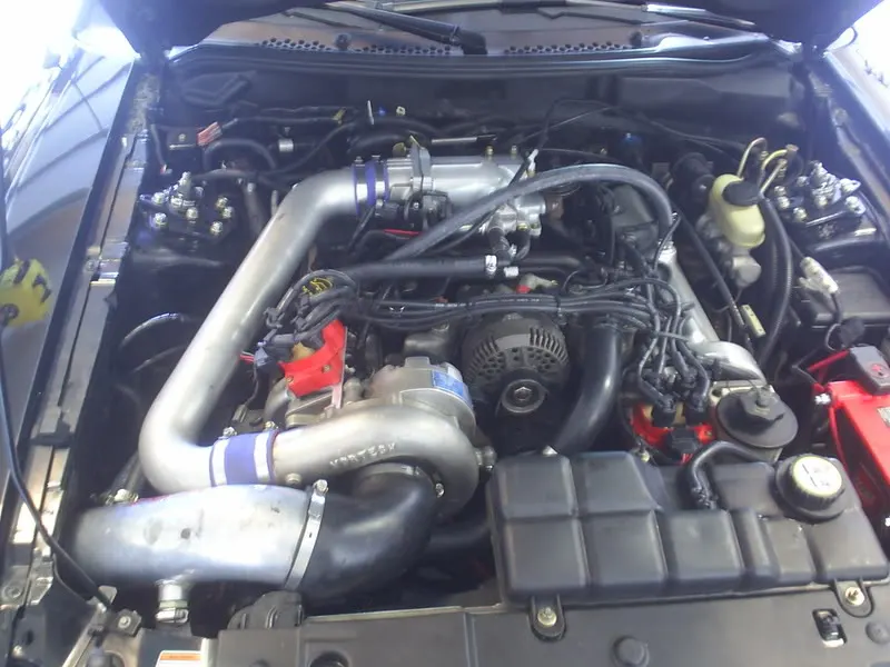

and if possible does some one have pictures of there car with blow-throught set-up i will need to know how to run the hoses thxs

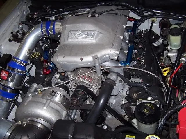

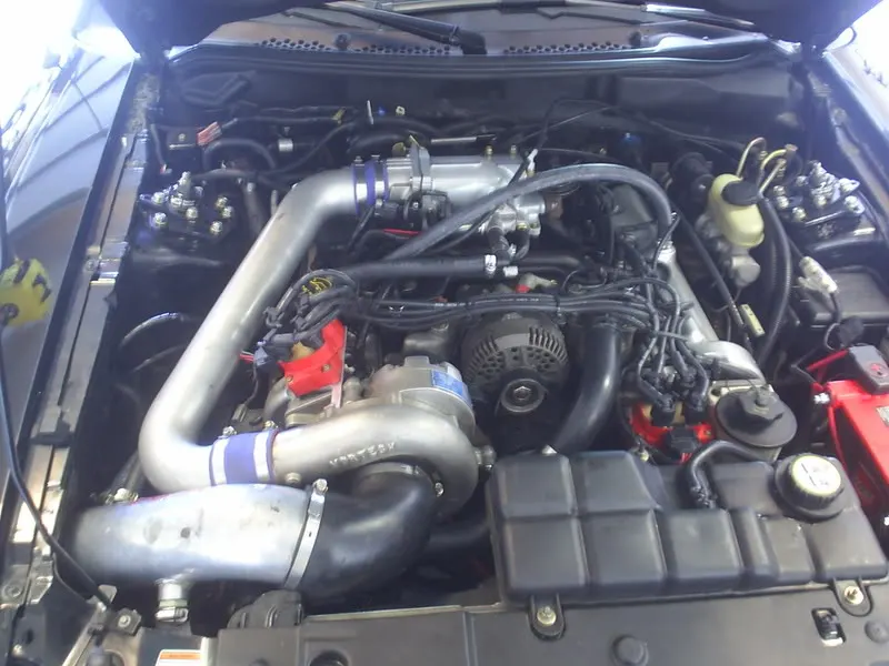

BEFORE

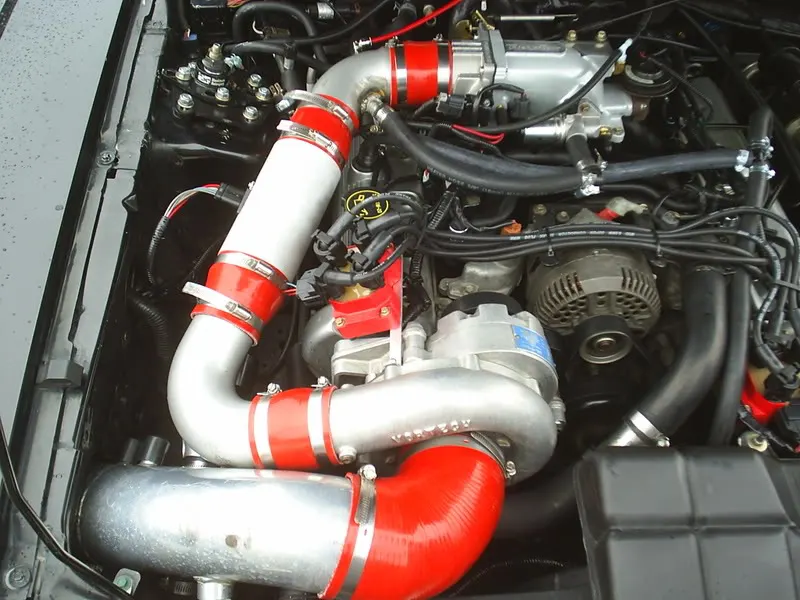

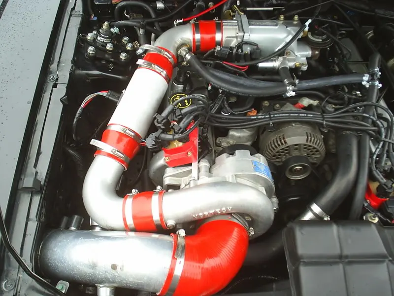

AFTER
I would change that setup...when you floor it your supercharger is pushing boost into the valve cover where your crankcase ventilation is. I don't think you should do that, it will pressurize the oil pan. Move those hoses to the suction side of the blower where its vacuum.
