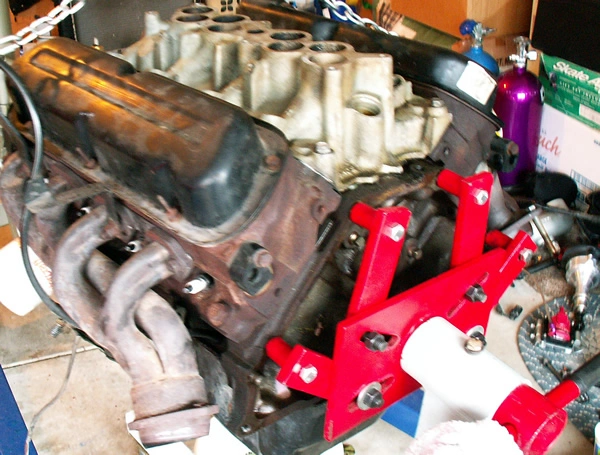

6.5 years of a LOT of nitrous. I "almost" made it to 200,000 miles before the rings let go. Nothing wrong with the heads or pistons at all.
The 125 shot is wonderful! :D Oh and for the naysayers... this was on a DRY shot. :nice: Look at those two purty bottles back there. :D
