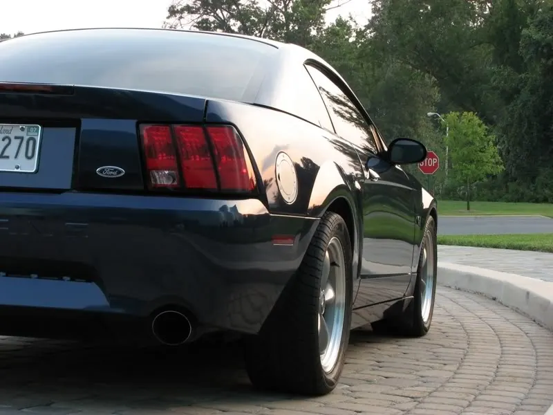

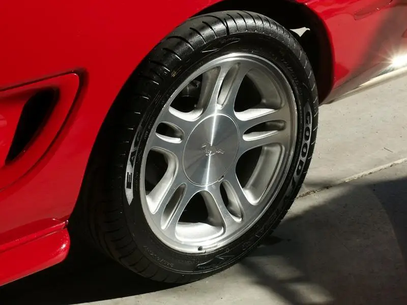

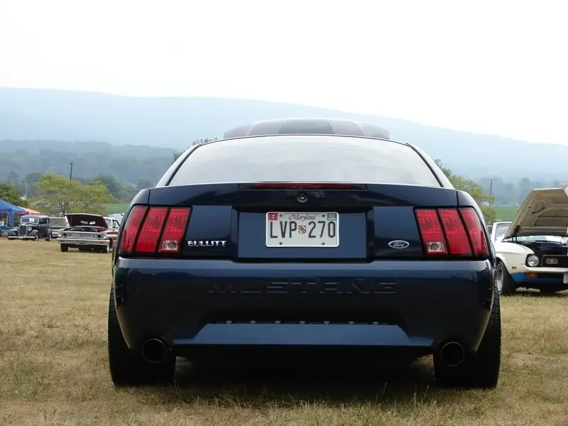

I've had my 1 inch H&R spacers on for about 2 years. Been lapping with them and drag raced MANY times. No problems.
The only thing I would suggest is buy a quality brand name set. Here are some before after pics.
BEFORE
AFTER

Man that's how Mustangs should've came from the factory..
