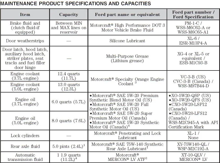

This is what is listed in the manual and if I'm reading it right, the first entry (the synthetic blend) is used in the V6 while the V8 uses:
•Motorcraft SAE 5W-20 Full Synthetic Motor Oil (US)
I read it the same way Weazl. I have an appointment in the morning for my first oil change (750 miles) and I will check with the service dept. and let you know what they say. If it came with synthetic blend I'm changing to full synthetic tomorrow.

The additives they speak of dont seem to match up with what is printed in the manual; it stated something about not needing any additives or special oils. My dealer said to bring it back for an oil change at 10,000 miles or when the message center stated to do so. Seems odd that an additive would be used for 10,000 miles.
