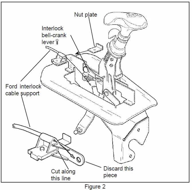

I have a 1991 GT that was originally an AOD car that was converted to 5 speed and I noticed that the wire coming off the ignition key lock cylinder isnt connected and I see nothing to connect it to. Did the AOD cars not have them connected to anything?
they were connected to the AOD shifter- only allowing the car to start in P or N. Here is picture of it from a B&M install guide
