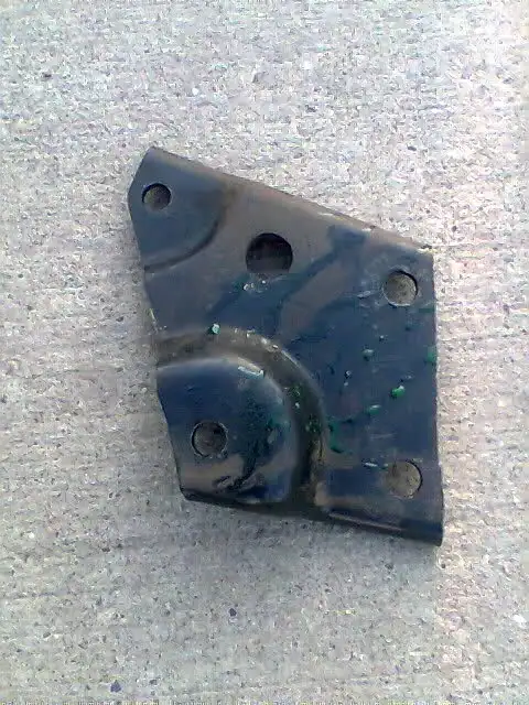

Hey guys i had the engine apart and need to know where this piece goes , any help is much appreciated.

Your guess is as good as mine. I cannot ever recall a piece like that on the foxes I have taken apart

Looks like the A/C delete bracket in between the water pump and the power steering bracket

I agree with ID89gt it looks like an a/c delete bracket.
Theres two parts of the a/c delete kit, thats part 1 in my picture.
Same thing I was thinkin

^^^That was my thought as soon as I saw it.

p/s reloction kit...

You guys rock ! thanks much. Also where can i find the plug that goes into the low oil sender on the oil pan. Is it located on the wiring harness somewhere?
