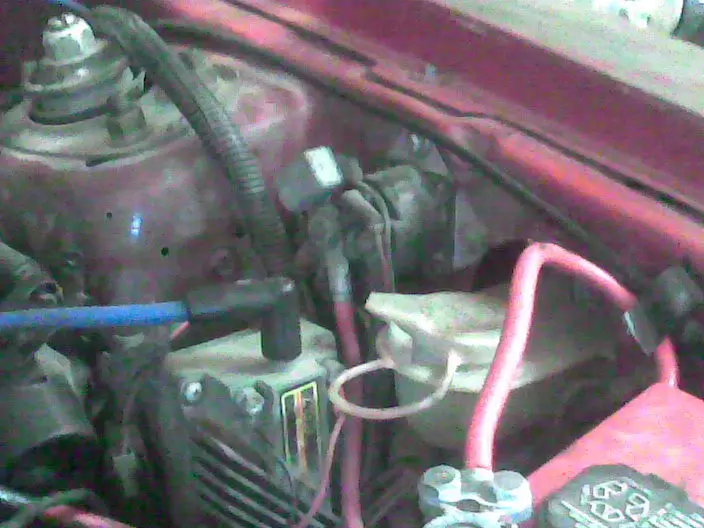

I have no idea where it is or what it looks like. Can someone describe it or show me a pic?

look right above where your coil is located. it's right on the right side of engine bay. you cant miss it.

here's a pic. sorry for the cameraphone quality.

Positive Battery wire goes straight to it

Follow the positive red wire take u right to it!
