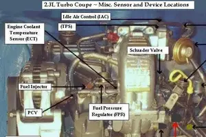

J jstang209 20+ Year Stangneter Jun 3, 2004 640 2 18 Stockton 209 Nov 13, 2004 #1 Nov 13, 2004 #1 For some reason im not seein one, can someone direct me or show a pic. thanks
1 140cilx Founding Member Sep 7, 2001 2,385 0 0 GA Nov 13, 2004 #2 Nov 13, 2004 #2 Right above the distributor, next to the head and cam cover and behind the alternator.
J jstang209 20+ Year Stangneter Jun 3, 2004 640 2 18 Stockton 209 Nov 13, 2004 #3 Nov 13, 2004 #3 Can i get a pic someone, i still dont see it. Mabey its gone lol? will a car work without it?
Stinger Founding Member Jul 7, 2001 7,754 24 118 Basehor (Kansas City), KS Nov 13, 2004 #4 Nov 13, 2004 #4 it's in a 1/2" rubber hose that runs from the bottom of the upper intake, down past the distributor, and to the back of the engine block...

J jstang209 20+ Year Stangneter Jun 3, 2004 640 2 18 Stockton 209 Nov 13, 2004 #5 Nov 13, 2004 #5 thanks, but im still not seeing it, i even took it to kragen and they couldnt find it either..
rgosulliv Founding Member Aug 10, 2001 430 0 0 Lawrenceville NJ Nov 13, 2004 #6 Nov 13, 2004 #6 follow the rubber hose from the bottom of the upper intake. right where it splits which is around the bottom of the front of the valve cover you dissconnect it. Inside the rubber hose is the PCV vavle. Attachments sensors2.webp 35.9 KB · Views: 198
