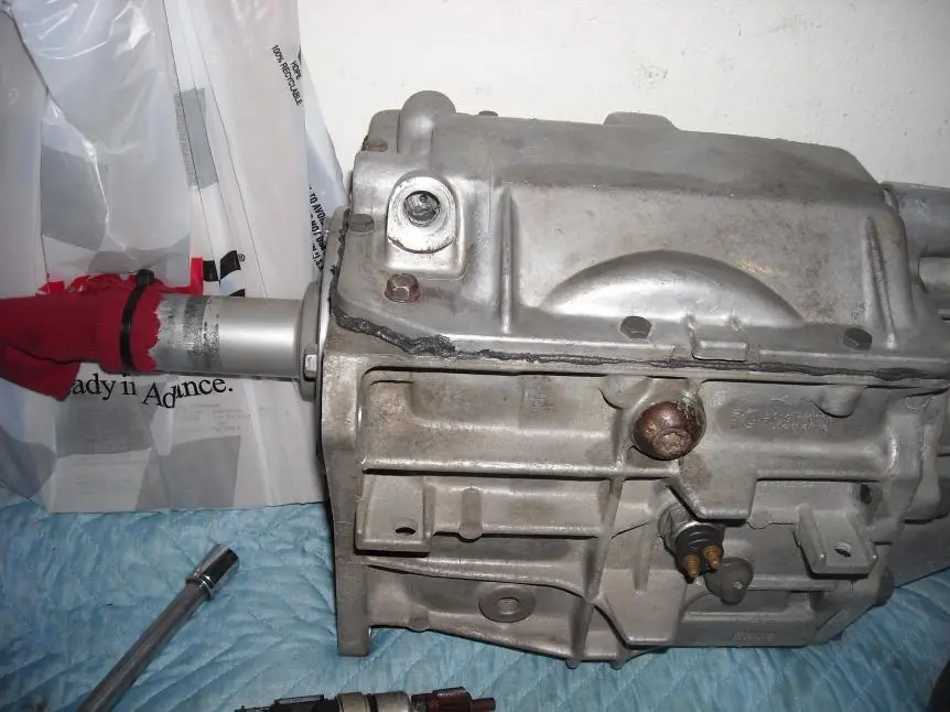

This switch goes on the top cover of the T-5. I had a older t-5 that didn't have this and the car would start up fine. I can't find this switch and the pin and I don't know if I can't run the transmission with the hole unplug.
Some guys have had luck sourcing them from a transmission shop or the junkyard. I have the pigtail to one that I got from a yard, but I was never able to remove the switch with the transmission still installed. I've yet to see a part number posted for one.
