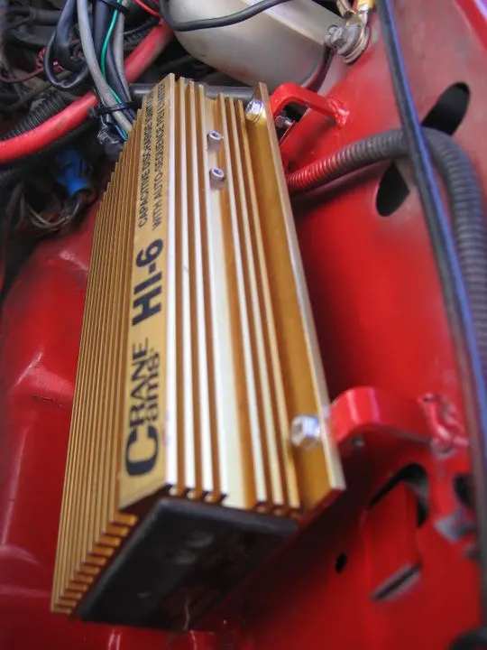

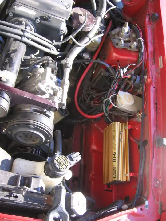

mine's on the driver's side of engine compartment where the battery used to be. haven't had any problems yet, but it isn't a daily driver
