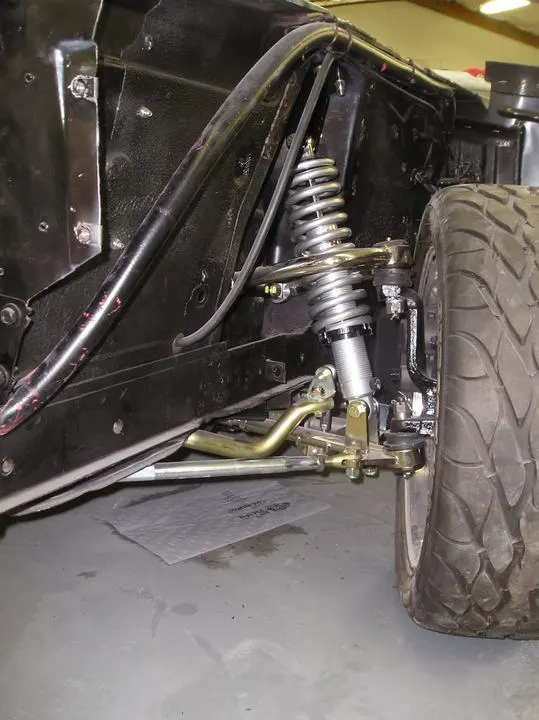

I went with a Ron Morris kit that I purchased new from Ron on eBay with what he said was slight blems in the finish. I Couldn't find them. I paid $1700 + $100 shipping. I have a Steeroids rack with tilt column. Less than $1500. It will give you a great combination.

I have not had a chance to take the car out yet. It is still at the body shop. I have heard great things about the kit on another website. One guy does a lot of open track events with his car and made a statement that with his old modified stock suspension he started to feel a little uneasy at 110 mph. With the new setup he can go 140 with confidence. The kit is very high quality and I like the idea it gives you better handling without rattling your bones with still springs. Would I do it again and pay full retail? Without a doubt.
As far as coil over systems go I think the best designed kit is the one from Global West. It puts the load of the suspension on the lower side of the shock tower. TCP, Aeroform, RM and the others sandwich the loan with metal plates above and below the shock tower. Does it make a difference? Probably not but the GW system is closer to how the cars were designed to carry the load. It wasn't worth the extra money in my opinion.
