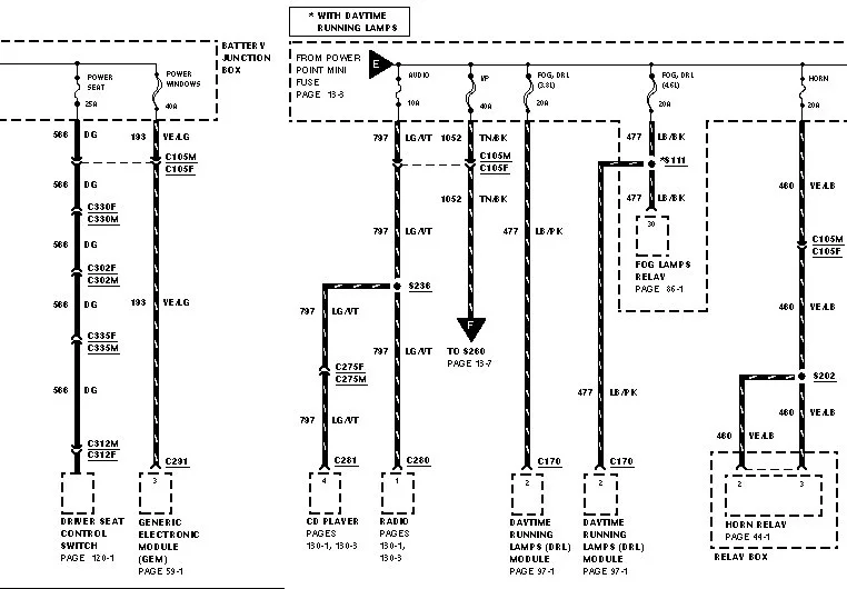

this is for a 99. it might be the same for you:

Thanks for the diagram, I appreciate it! Which fuse does that go to? I don't know a lot about reading those diagrams, I am a mere dentist....I can't see where the fuse is on there..

for a 99 its a 25A fuse. which i am assuming is to the right of the 20A horn fuse and to the left of the 40A Power Window fuse based on this picture

found it, you guys rock! I didn't realize it was a fuse under the hood. That fixed it!

i am curious if this wiring diagram i posted is accurate for your year? i am assuming yes but i want to double check with you

I am honestly not sure...I ended up looking in the manual and found it under the high power fuses...I figured it was inside the car...but not the case..
It was the fuse under the hood on the lower left side...if the big ones are at the top...if that helps at all..
I think they are the same from those model years up to 2005..
