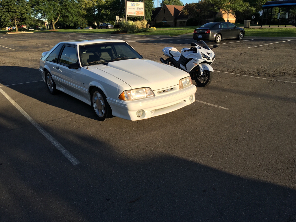

I have an absolutely beautiful 1990 Mustang cobra clone. She has some bolt ons, heads,cam, 24lb injectors, intake and a few other items. I am looking for a power adder. NO NOS!. I'm thinking of a pro charger or turbo. Question what would you all recommend and is there anywhere in SE Michigan that would install it for me? Thanks in advance
