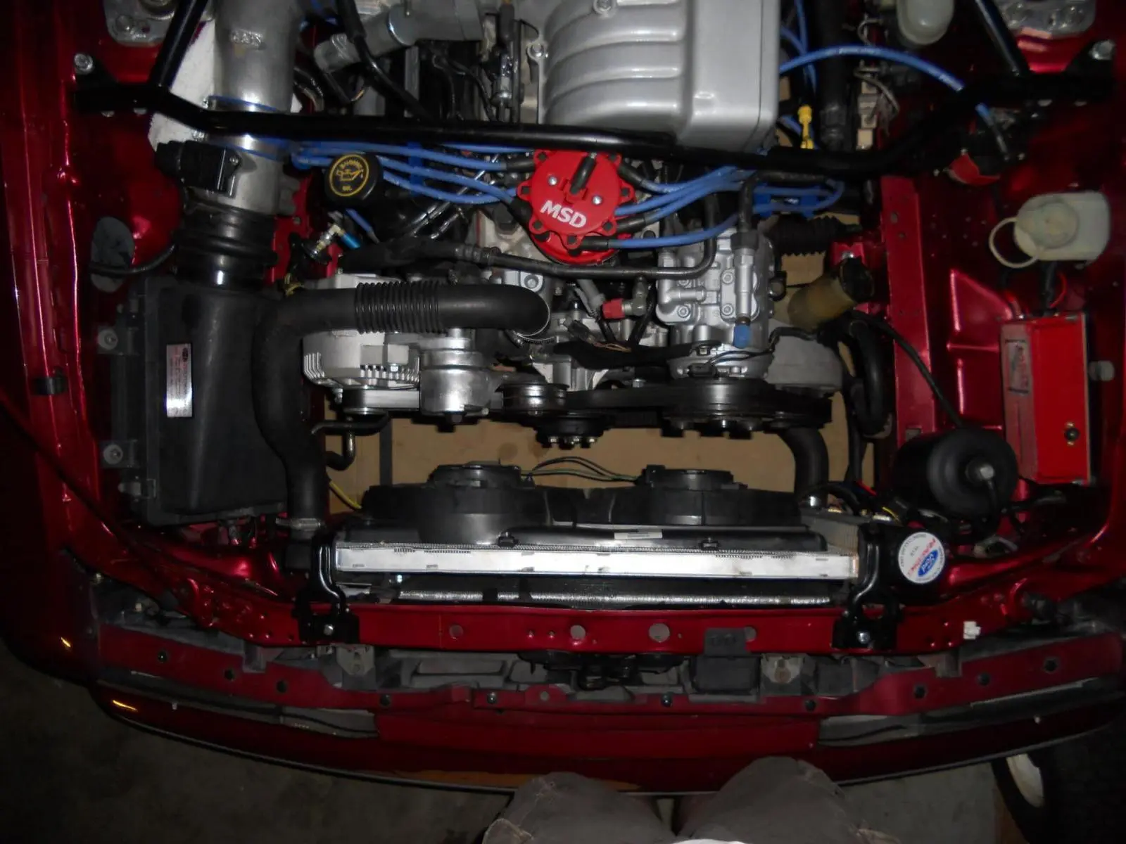

Can't really tell you one that will work. Mine came on my car when I bought it, I think it may be a BBK. It rubbed the edge of the Cobra intake I had, but when I swapped to the Edelbrock intake there was no way it would work. I notched it, then used some flat steel to weld it back up and shot it with some spray paint. Just an idea.
