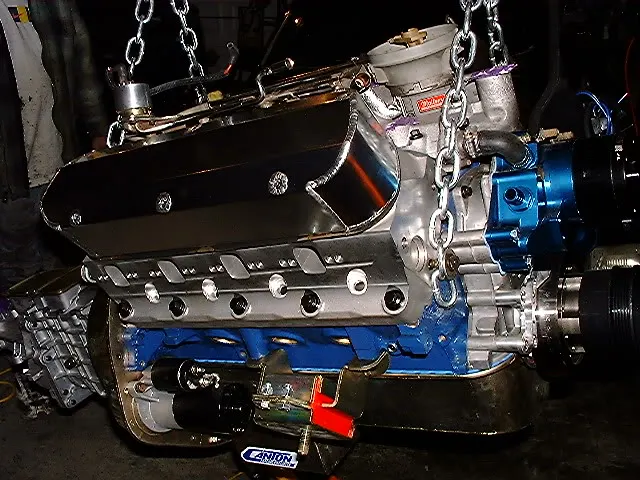

you mean like these... i think these are 4'tall not sure though. i am running a 3/8 spacer on my intake. they cleared a set of scorpions, and now are covering a set of harland sharp customs.

the ford ones that say they don't work for EFI is cause they have a breather hole in each valve cover. this will cause unmetered air to enter the system. if you plug one of the breathers off, and ran the other to the TB like stock, you should be fine. they will still fit on a SBF, may have to order the tall version to clear roller rockers.
:drool: me likey, me want hahaha
