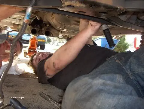

here is the height mine was at...

Didnt jack motor? Will engine not fall when tranny is off? lol..........Mine is a lil bit lower, but the highest I can get it.
