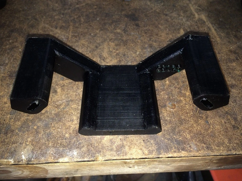

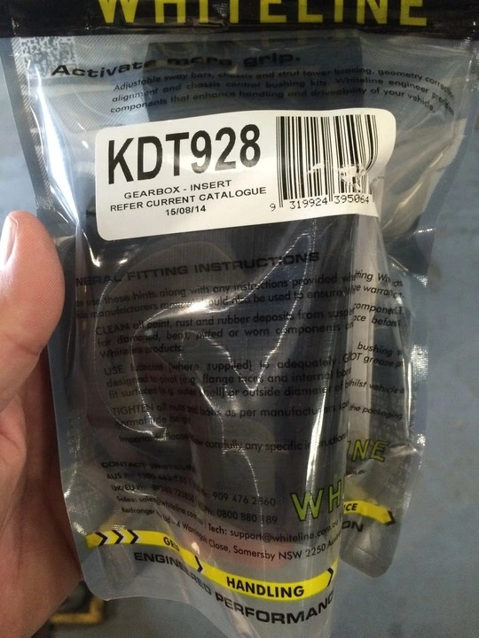

Wish I could say this was even remotely interesting but it literally took me longer to put the car on the lift than it did to put the bushing in.....

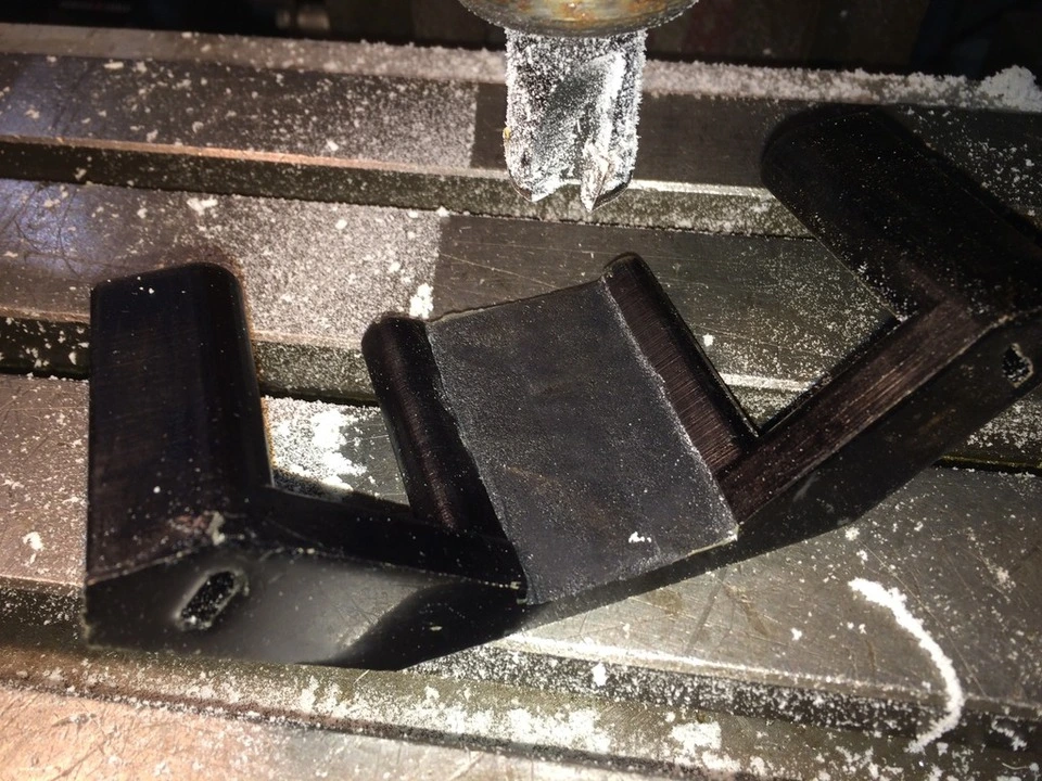

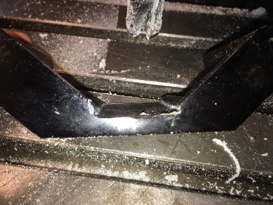

Instead of just drilling a hole through it, what I decided to do was put it in the mill and and take some material out of the center section. It was .350" thick down the center channel and this is the area that has the only hard contact with the actual trans mount.
Now, I had to hand jam this through the mill, there was no way to hold it securely. It's too soft to clamp down on and clamping it from one side simply distorted it. So, I had to hand feed it and took .010" off at a time so the face mill didn't yank it out of my hand. DO NOT DO IT THIS WAY IF YOU HAVE AN OPTION! It is NOT safe to do!
Anyways, I took .100" off the center section to try and put more load onto the softer areas of the mount. We'll see how it does.....

That made a HUGE improvement. There is no noticeable change in harmonics or vibration throughout the RPM range now.
I smashed on it through 4th gear and it was still smooth through the gears. I intentionally knocked the tires off through 3rd gear with TC off and LC on RPM mode only and each gear felt solid.
It doesn't do anything about the clutch feel, but that's another issue entirely.

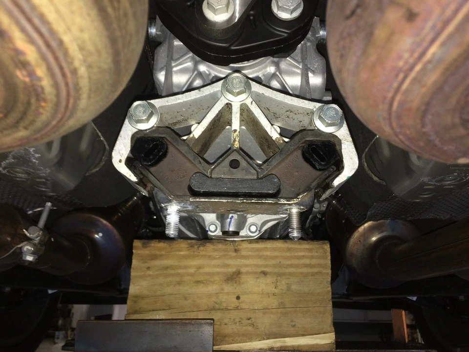

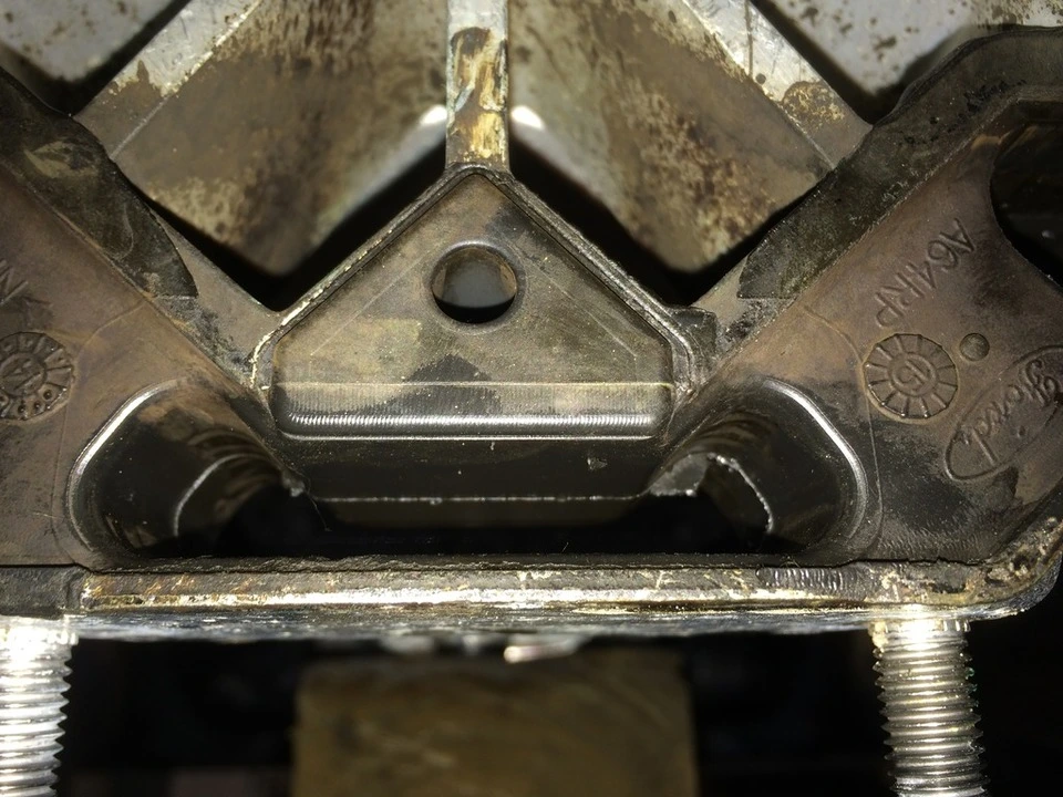

The issue is under heavy load (i.e. full throttle / grabbing gears), there is a bunch of flex in the factory trans and engine mounts. This is great for vibration damping, but it's not great for power transfer / consistency. The biggest problem is under load going to 3rd & 5th gear.....you have to feel for it a bit, it's not a quick engagement.
The trans bushing is suppossed to help with this, but by stiffening up the mount points you end up with some negative effects (noise, vibration, harshness). When I looked at the OEM mount, all the voids in the rubber are soft spots, no hard contact....except the bottom of the mount in the center (the area where I removed material). This is the only spot where it makes hard contact with the OEM mount and is likely the spot transmitting the noise / vibration.
The problem is, if you want a rigid mount, you have to fill the voids. If you fill the voids with a denser / less flexible material, you transfer energy in the form of heat, noise, vibration, etc.
You end up with a trade off.... A solid mount that shifts well, but has some undesireable characteristics. Or, you leave the OEM mount alone and have a bit of notchy shifting to 3rd and 5th.

Without a doubt the shift into 3rd and 5th is much crisper when you're smashing on it.
For $30, I'd do it again, even with a little massaging to make it how I want it.

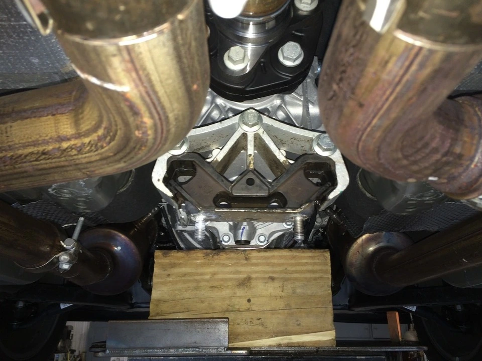

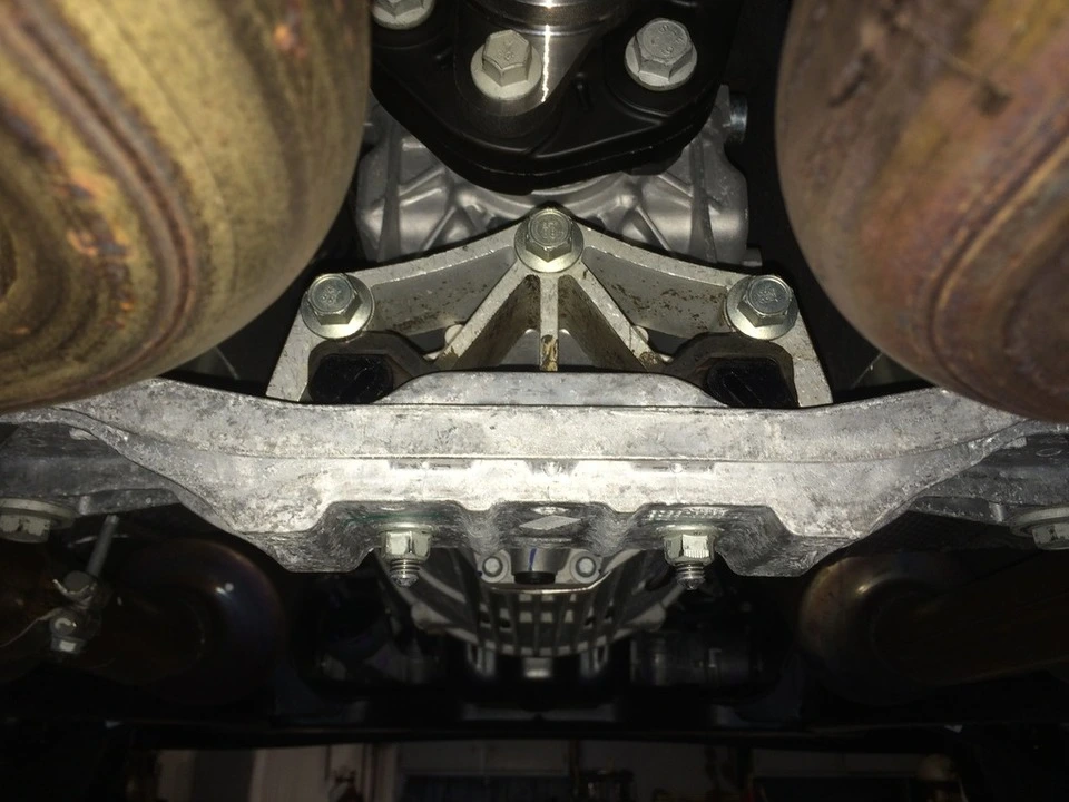

What resides in that space before this stiffener/bushing is installed?
SilverS550
Mar 5, 2015
162
44
38
East Alabama
Mar 23, 2015
#14
  • Mar 23, 2015
  • #14
Empty space....
