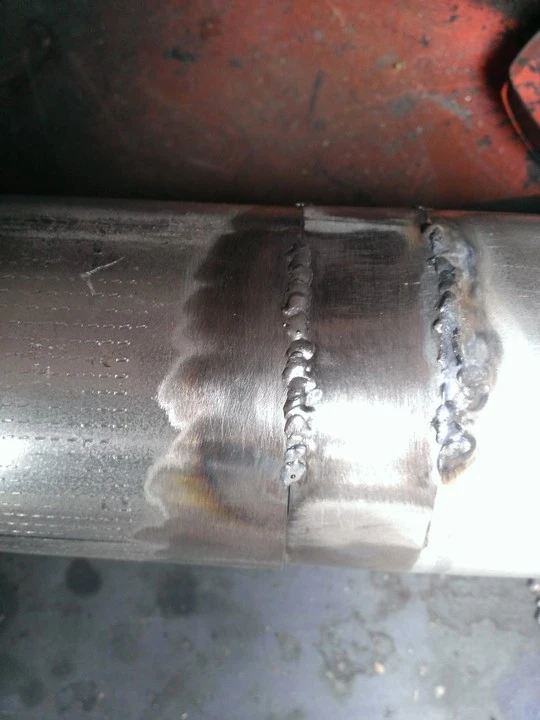

This:
This god awful result is what I get everytime. I know that 90% of the is technique, and I lack technique. I manage to completely weld the seam w/o burn through, but it seems that everyone of these I do end up looking like this. Then theres the monster on the right. I blame that on the fact that the aluminized coating wasn't ground off the one tube, and it just went all to hell.
What is the setting supposed to be on that regulator, and where is the ball supposed to float in the tube, and how is it checked?
your running to cold on the first weld and more filler on the second best I can tell. You might want to turn your gas up a little bit. whats your welding system look like?
I am just beginning with tig welding. Do decent beads with steel now and just started with alum today, which somehow seems easier? I found the biggest thing for me, possibly because I am left handed I was following the torch with the rod rather then the torch following the rod. Once I made that change things really started looking better. Been having the gas set 15-20. Are you using straight argon? What tungston? Also looks like you need more heat on the weld to the left. One to the right looks like the heat was there but I have no idea why it looks like that.
Gas should be set @15 on the regulator. You look way to cold on the left side, needs quite a bit more amperage. The right side is just dirty, that aluminum coating is impossible to weld through cleanly. You might want to find some way to rest your hand better. The more comfortable you are while.welding the better the result. I have 2x4's 4x4's and even an old paint can handy to prop my arm up to be comfy.

Been waiting on you to reply, How do I set that regulator? do I have to trigger the gun to get gas flowing to set it? Or do I just turn it up to where the ball will float on the guage?
I'm really steadily set when it comes to welding, and I've got more than enough amperage to melt a hole right through the tube, The reason it looks cold is beacuse I'm not flooring the thing after I drop the rod to spread the puddle. ( I'm still concerned w/ just getting the thing completely welded as opposed to making it pretty) But I want to learn, so I wanted to make sure I'm set right.
There is a difference between tungstons?
You have to set the gas flow with the Tig torch running as supposed to it being static. I usually start really hot to get a puddle going and then back way off with just enough heat to keep it consistent. (I am also impatient lol). I personally use 2% thoriated (red) tungsten on almost everything. 3/32 is my go to unless I'm doing something intricate and will use 1/16 or even .060

Couldn't have said it any better 84... Red for steel, green for alum.. The grinding to a point with grind lines heading to the point is key. I only TIG at work occasionally so I can't have a dedicated wheel for the electrode. I would say set the welder around 100A and start there. Heat up the steel before you shove the filler in.

Went by a friends shop today who is an accomplished welder, and I got some OJT. I was quickly able to find out what I was doing wrong:
Not enough heat.
Reduce the size of the filler rod.
Not enough time behind the gun.

Always use the smallest filler rod you can safely get away with. If your filler is to thick and doesn't melt all the way, you will have penetration problems. Remember that adding filler cools the puddle.
Torch angle, torch angle, torch angle. Extremely important in all types of welding. But more critical in round stuff. It's very easy to get your torch angle off when moving around the pipe/tube.
