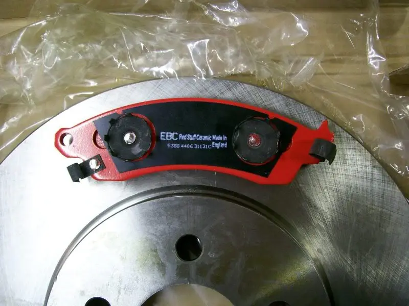

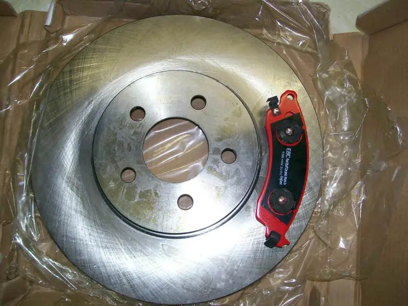

I'm replacing my front brakes. Everything is the right part #'s. But after looking, why are my pads so much smaller than the actual rotor...it looks like the pads would cover alot more area on the rotor than they actually do...i see no point in a 13" rotor if the pad can't cover every bit of it

I think that if the area of contact is further from the center of the rotating mass then it will stop better. Next time you have your front jacked up get the wheel spinning and try to stop it with your hand on the tread, then try again with your hand somewhere closer to the lugs.
This is absolutely correct. You can apply exponentially more force on a rotating object by increasing the tangential distance of the force applied to that object. It's called increasing the moment arm of the system.
The other way you can make your brakes work harder to is install calipers with more clamping force (your brembo's, etc with 4-6 pistons). This will increase the coefficient of friction that the rotor's experience.
