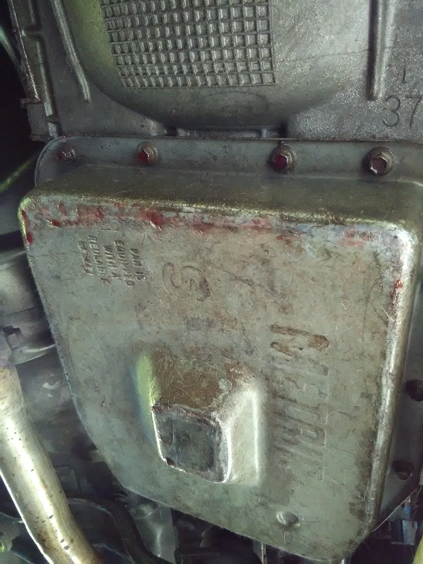

I HAVE A CHANCE TO UPGRADE MY 96 THUNDERBIRD. IT CURRENTLY HAS A 96 STANG GT 4.6. AND THE TRANSMISSION IN PIC. ANYHOWS I CAN BUY A 2004 130,000 STATE BULL POLICE CAR. ENGINE IS NICE AND TIGHT AS WELL AS TRANNY. ITS A DAILY DRIVER I CAN GET IT FOR $600.00. WILL THE INTERCEPTOR MOTOR/ TRANS DROP IN AND WORK WITH MY STOCK HARNESS/ECM. SHOULD I KEEP THE HARNESS/ECM FROM THE COP CAR. THANKS A BUNCH DAN

Don't expect a 4R70W from a 2004 to directly "plug and play" with a 1996 PCM. Check out tccoa.com as they have guides on how to modify a late model transmission to work with an older PCM.
http://www.tccoa.com/articles/tranny/transmission/index.shtml
http://www.tccoa.com/articles/tranny/transmission/page16.shtml <rewire>
The other thing that will get in the way is the speed sensor. The 1998 and older model years use a VSS sensor. The 1999+ uses an OSS sensor. The sensors are NOT compatible to each other. The sensor type must match what the PCM is expecting as well as the wiring harness design.
Here's some more information that may help you understand the difference between a VSS sensor an a OSS sensor.
http://www.allfordmustangs.com/forums/4-6l-tech/140694-t-45-tail-shaft-swap.html
For a "plug and play" experience recommend keeping your original automatic transmission. Otherwise some re-engineering is in your future.
