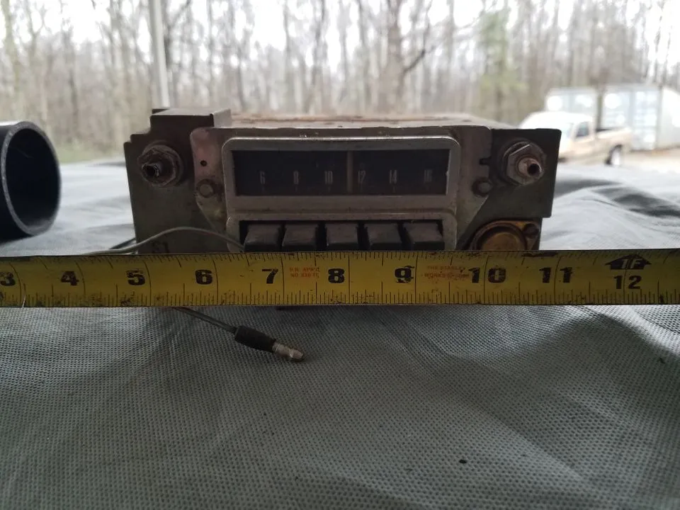

What does your dash hole look like? Retro Autosound has a lot of kits with adjustable knobs(horizontal and vertical axis) that will fit a ton of different vehicles...probably your best bet. The '66 radio:. 5 3/4" knob spacing(center to center) 3 7/8 x 2" faceplate opening, this picture will help with the knob centerline offset:
