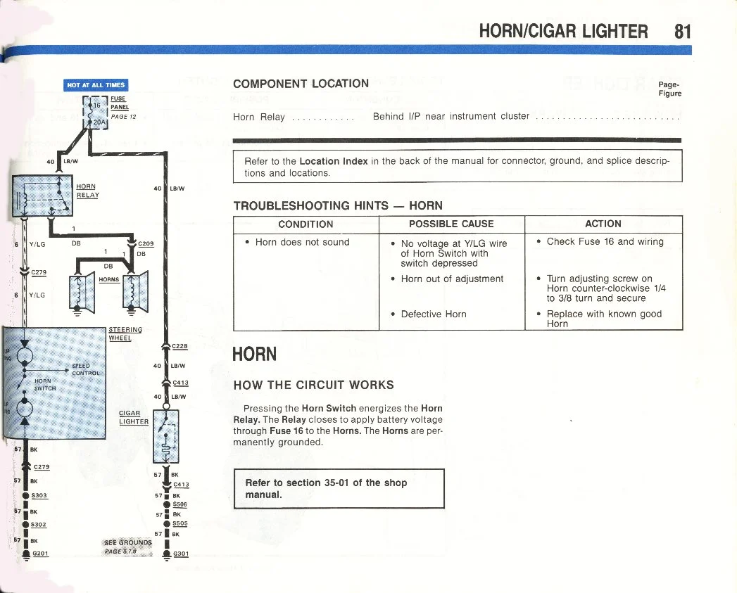

My 93 is missing all of its horn components. I just installed a MOMO steering wheel. Will a 2015 Mustang OEM horn pair work ok? I'm thinking a horn is a horn, right? I will just need to attach a relay/fuse and power it with 12v+ from the battery and of course use a ground?
