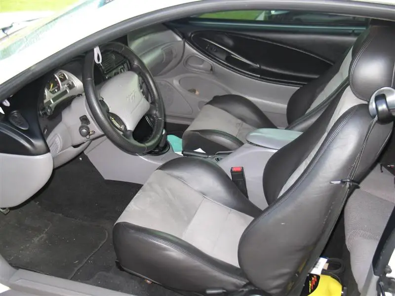

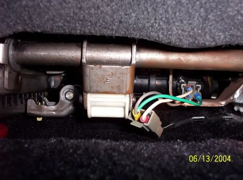

I cut the connectors on mine though. And just crimped (on 03 cobra seats ymmv) the 2 green wires on the seat to the power wire from the car. And crimped the 2 ground wires. I did use spade connectors so I could unplug the seats for removal.
99-04 belt buckle will not accept 94-95 seat belt. You'll have to remove buckle on 99-04 seats and use your 94-95 buckle that's on your center console. newer model seats does make the car more comfortable but I didn't splice mine. I'm still looking for a manual track that will fit my 03 seats.

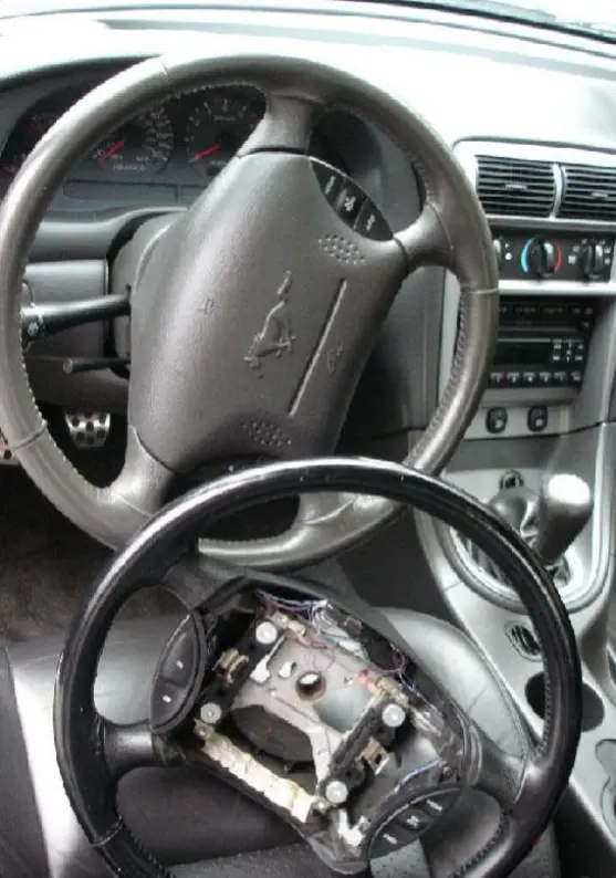

However keep in mind the colors changed slightly on the 99-04 cars vs the 94-98 cars. All three shades changed slightly.
Heres an example. Here's a black 94-98 steering wheel compared to the interior of my 2003 GT
