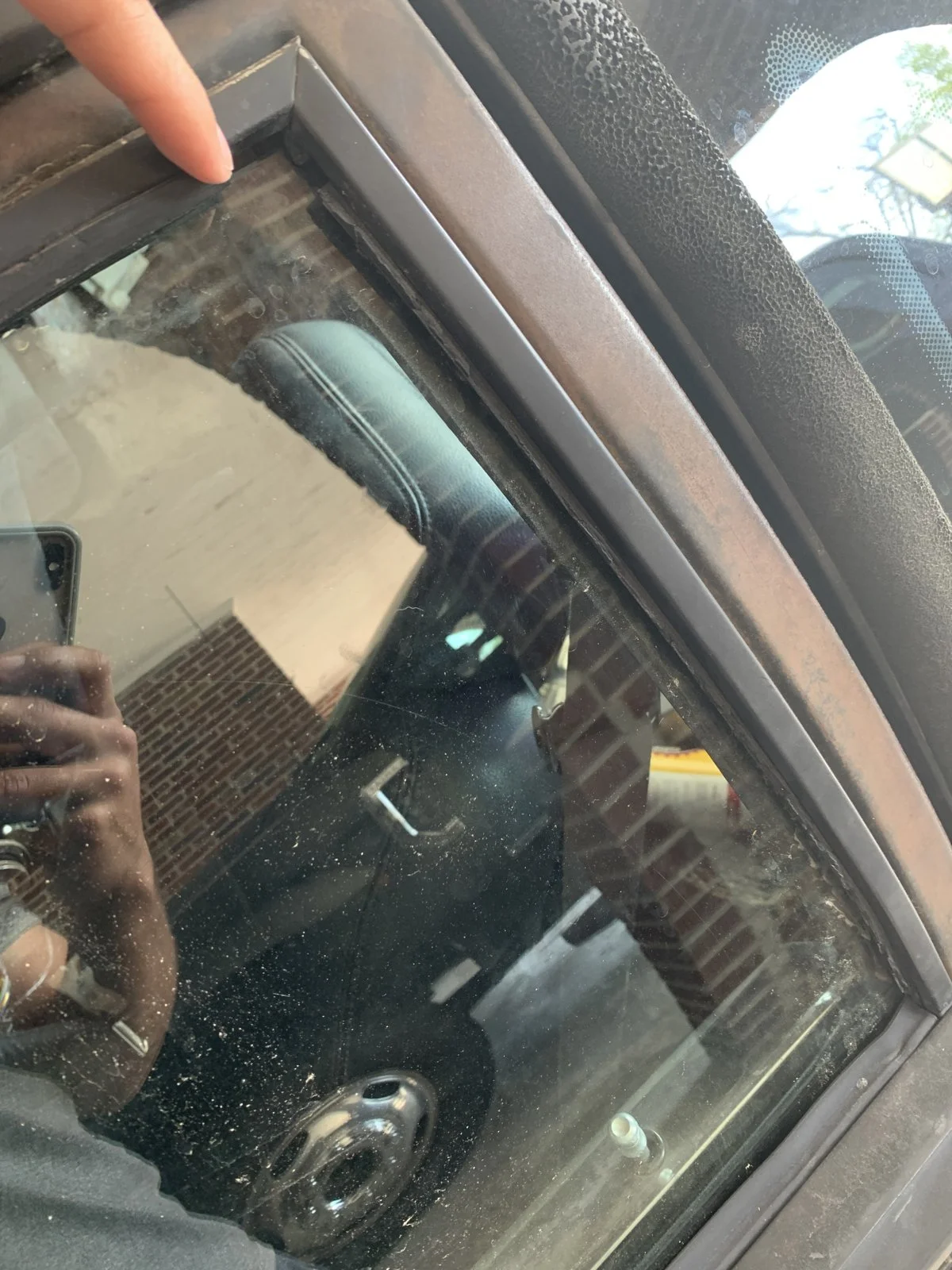

+1 Be aware, pulls right out, doesn't push right in!
If your replace it, pull the door panel first because you'll eventually need to get to the lower section of the run channel. When you install the new one I have two tips for you. 1) Start installing in the upper rear corner first. You can then work forward or down next. I usually start the down section *rear part of the frame). 2) Use plenty of lube, either silicon spray or WD40 (my preference). Don't spray the felt side, just the channel and solid rubber. I use a piece of paint stick inserted into the window slot section to work it into the run channel. Some people arguably rate this as the #2biggest PITA Fox repair (heater core replacement being #1). Good luck!
