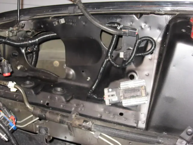

Well, you need the 5.0 computer too, and of course the engine wiring harness. There's a module on the coolant reservoir bracket that you need to swap. Andf you need to install the TFI module. If you have the 5.0 fuse box I would verify all the fuses and relays are in the V6's fuse box.
The TFI module is on the passenger side of the engine compartment, near the shock tower. It has an aluminum heat sink on it. Here's a photo (with the engine out, of course):
thanks alot!!!! one other thing we tried starting the car with out having the ecm tfi and the harness on the passenger side switched do you think that that could be why we didnt have any spark????
thanks alot, you dont even know. did all that today and she fired right up!:hail2: but theres one more thing in the crash on GT the was a hose that comes off of the smog pump and it goes threw 2 filter tipe thing im not realy sure what they are, but anyways the first filter thing got burnt so i took it off and now i dont know where it is, you wouldn't by any chance know if you need or what it is called so i can get a new one:shrug:
