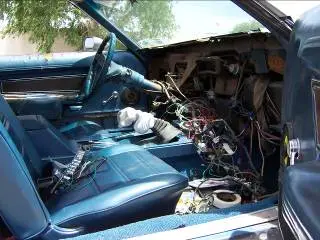

So I finally started pulling out my old wiring harness today. Boy is that a chore. To get at all the wires I had to pull the face of the dash out along with all the air ducting. :spot:
