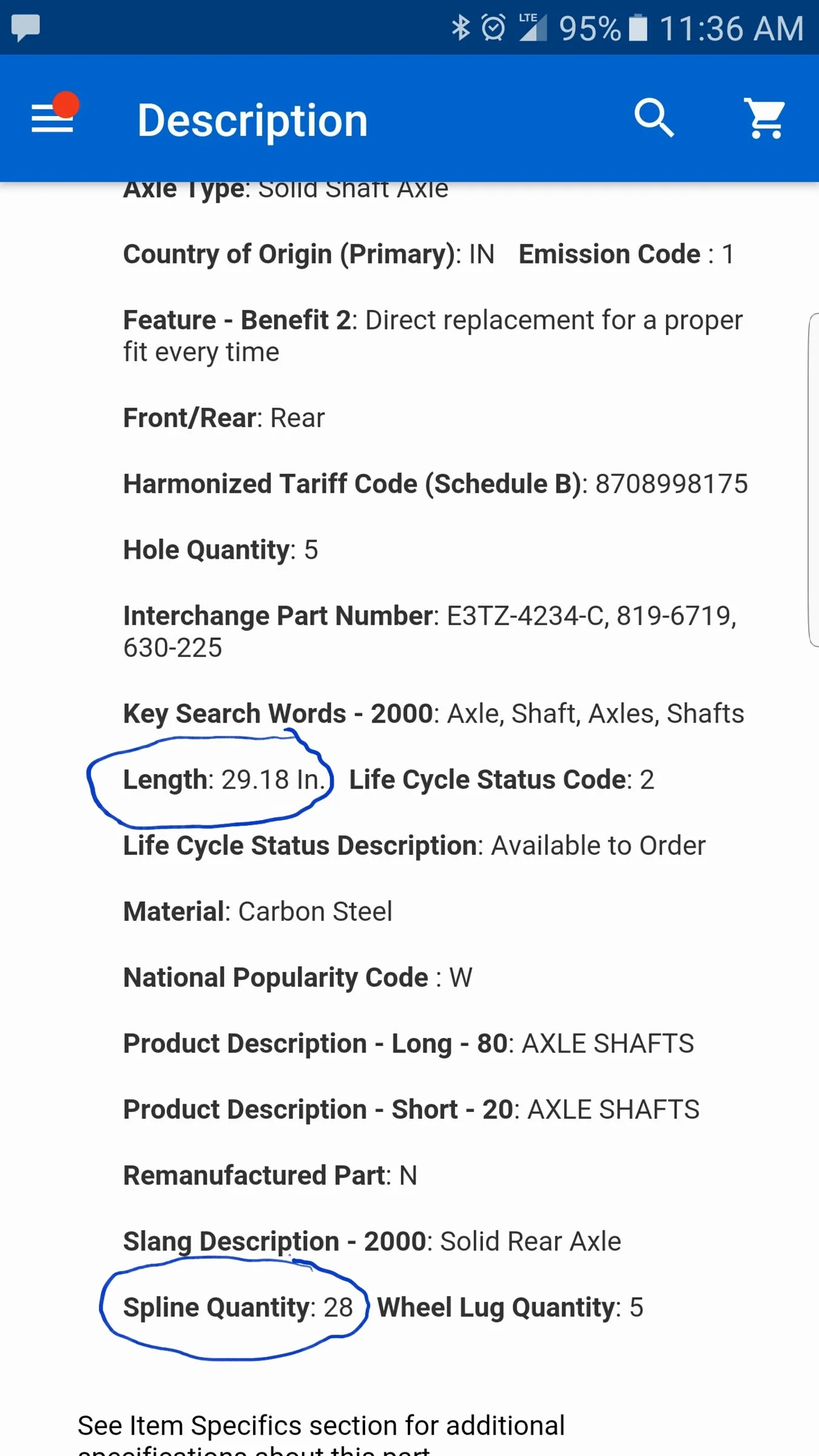

does the circled areas seem about right. The measurements seem to be in a different format on all the ones I've checked so far.

29 5/32 is 29.16.
28 spline is correct

Could you appoint me to the easiest place to buy this? I can't seem to find the right one with those specs.

I'd buy that one based on what you posted

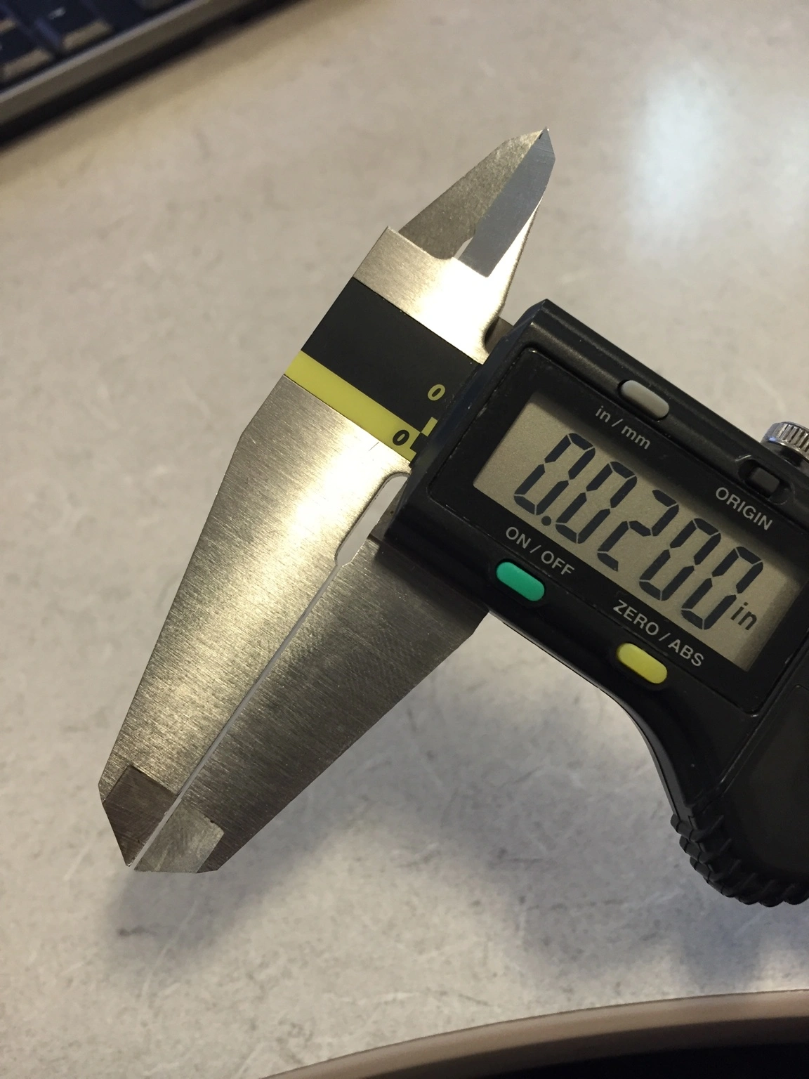

0.02" is this much.

Okay. So the specs on the one i posted should work? I'll order it asap. Thanks!
