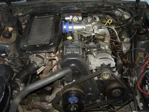

I drove it today and its runs poorly. Rough and hunting idle (IAC). Stumbling and hesitation before 4500rpm (VAM?) so i'm gonna do a tune up hopefully this weekend and see what i come up with

i couldnt get the camera to work but it measured about 65mm so i wonder if this could be the problem. i checked the timming its sitting 10btdc i'm almost wondering if it jumped time just by the way its idleing regardless its still an awesome deal, which leads me to another problem

the tbody is a 65mm not sure who made it or where it came from. came with a free boost gauge and an a/f ration gauge in the pillar.
I went out to drive it last night, it hunts at idle for about 30-45 seconds when cold. i think the iac is sticking cause i was able to tap it with a rubber mallet and idle flatend out. I was excited to find a large VAM and brown tops in the car and the PE ECU. This guy seems to no jack about what was on the car but this engine has been gone through. It seems to run way faster then my 86.
