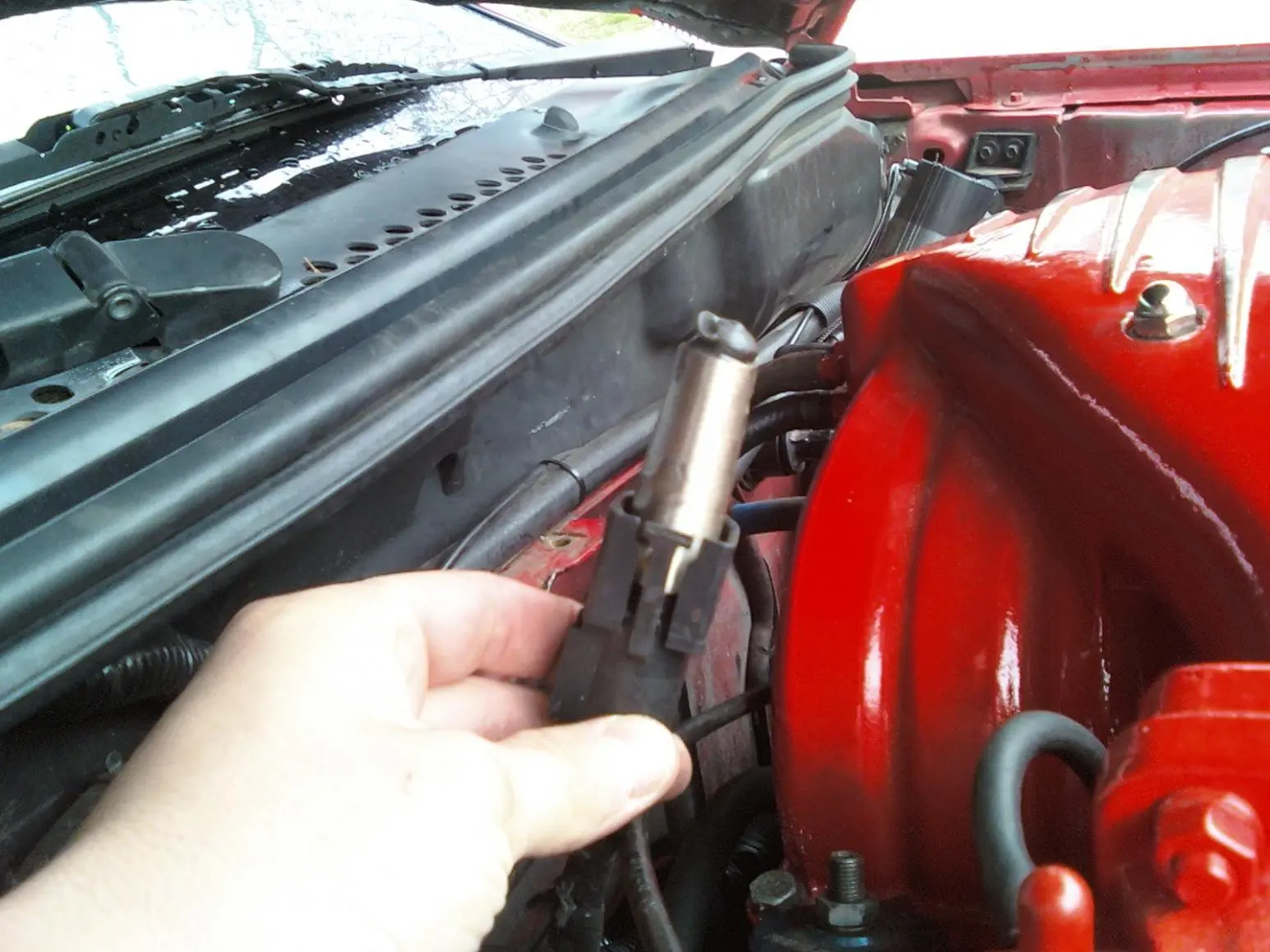

anyone know what this is or where it goes
9 94excoupe New Member Nov 23, 2009 58 0 0 Mar 18, 2010 #1 Mar 18, 2010 #1 anyone know what this is or where it goes Attachments mustang wtf.jpg 188.3 KB · Views: 126
94 Cobra 5.0 Member Sep 18, 2004 114 0 16 Ft. Riley, KS Mar 18, 2010 #2 Mar 18, 2010 #2 That is the connector for the egr valve. The thing connected to it is a simulator to make it look to the system that the egr valve is functioning.

9 94excoupe New Member Nov 23, 2009 58 0 0 Mar 18, 2010 #3 Mar 18, 2010 #3 ok dumb question. what happens when its not hooked up?
revhead347 Apparently my ex-husband made that mistake. 15 Year Member Jun 14, 2004 9,133 1,675 214 Acworth, GA Mar 18, 2010 #4 Mar 18, 2010 #4 I didn't even know they made EGR sims. Kurt
revhead347 Apparently my ex-husband made that mistake. 15 Year Member Jun 14, 2004 9,133 1,675 214 Acworth, GA Mar 18, 2010 #6 Mar 18, 2010 #6 Nothing. It is just a way to take your EGR off, and keep the CEL fom coming on. Kurt

9 95steeda Member Oct 14, 2003 37 0 7 Mar 24, 2010 #12 Mar 24, 2010 #12 94, not sure where you are located, but if you have to get your car inspected and they hook it to a sniffer to check your emissions, you might fail, especially if they look for NOx. The EGR reduces NOx and pinging.
revhead347 Apparently my ex-husband made that mistake. 15 Year Member Jun 14, 2004 9,133 1,675 214 Acworth, GA Mar 25, 2010 #13 Mar 25, 2010 #13 If my car can pass without an EGR, any car can. I don't think it makes much of a difference. And GA does check for NOx. Kurt
