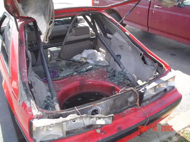

Here's what happened w/my lovely rear mounted battery.......you should feel lucky.....
Well anyways.... My buddies car had electrical problems w/his rear mounted setup and he took it to the dealer and they added a ground strap up front from the motor to the body near the strut tower, they said the small ground wire behind the motor to the firewall was not enough, so they added another and...walaa, no more problems! :cheers:
