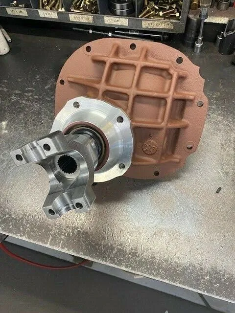

I'm also assuming any Ford 8" center section is a direct fit replacement also. Can anyone confirm that?
