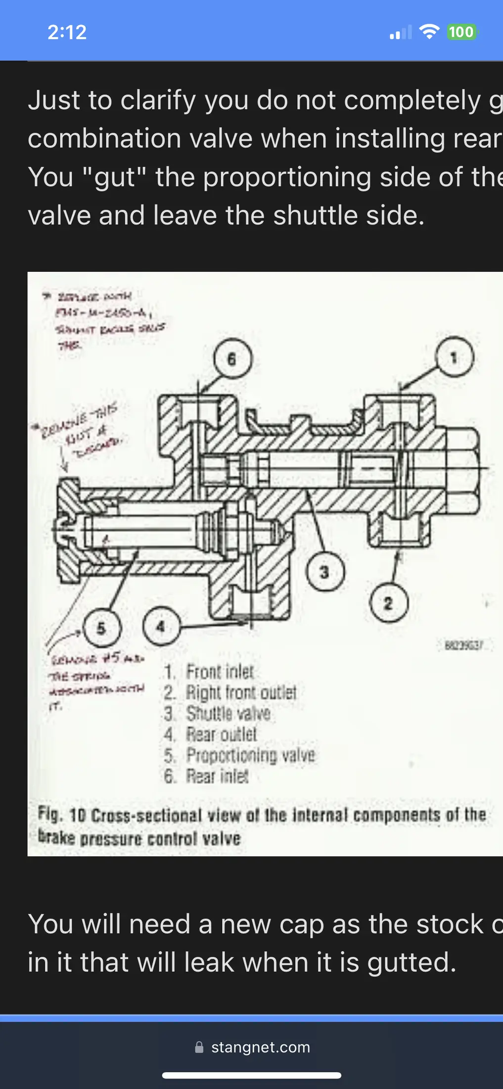

John Birone 15 Year Member Nov 19, 2012 52 10 18 Raleigh, NC Mar 24, 2023 #22 Mar 24, 2023 #22 Forgot to attach! Attachments 97EFD64F-1B67-4568-90E2-2AE6AC7279F9.png 1.2 MB · Views: 51

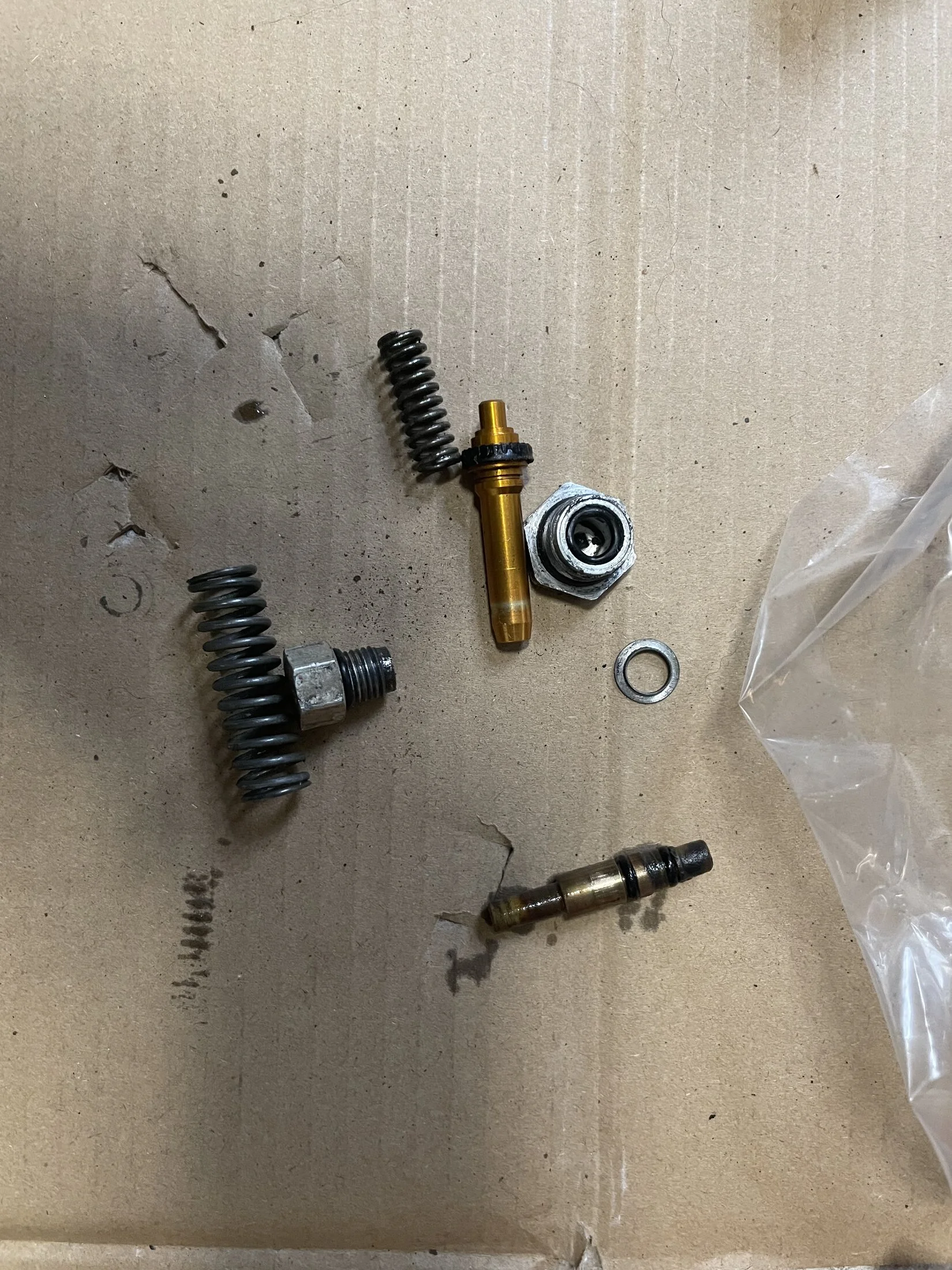

John Birone 15 Year Member Nov 19, 2012 52 10 18 Raleigh, NC Mar 25, 2023 #23 Mar 25, 2023 #23 Never mind, I’m an idiot. It was hiding in there! Lol! Attachments CD4F086D-7BEC-4CE3-B25B-2811124609FD.jpeg 799.2 KB · Views: 40 Reactions: 2 users
