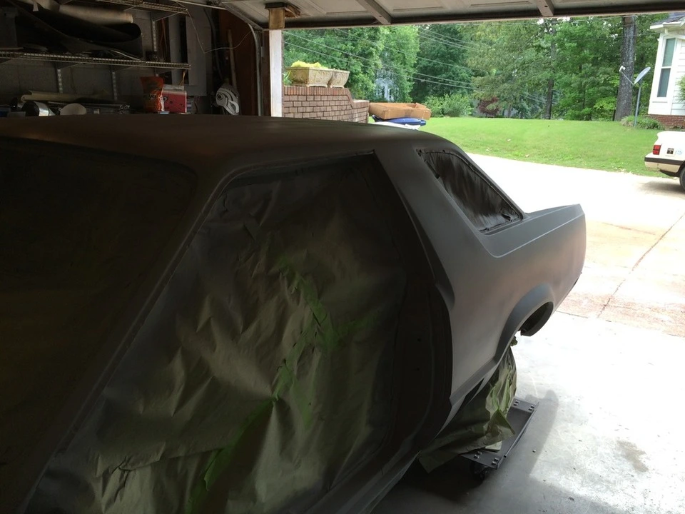

So,....now that recognition has been handed back out,....I blocked the passenger side of the car w/ a #320 grit dry.
It loads up after about 3 passes back and forth, and then little primer chunks form on the paper that force you to stop, and clean the paper off. Then 3 more back and forths,....and clean the paper. Sand, clean.......
I did this after an hour of the paint drying yesterday.
Maybe I was trying to do this too early
@Davedacarpainter?
Maybe I put the tires on it, roll it out, and wet sand the whole thing w/ 400 instead?
