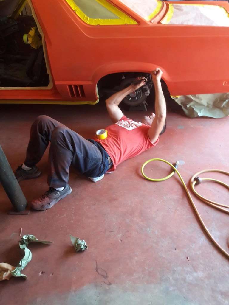

(He took a pic of me,.....Looking old, curmudgeonly and too tired to even stand up straight).
I'm not happy about that.
Not happy at all.

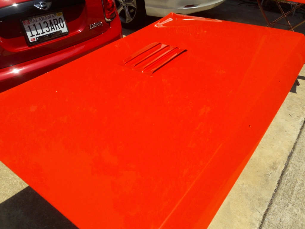

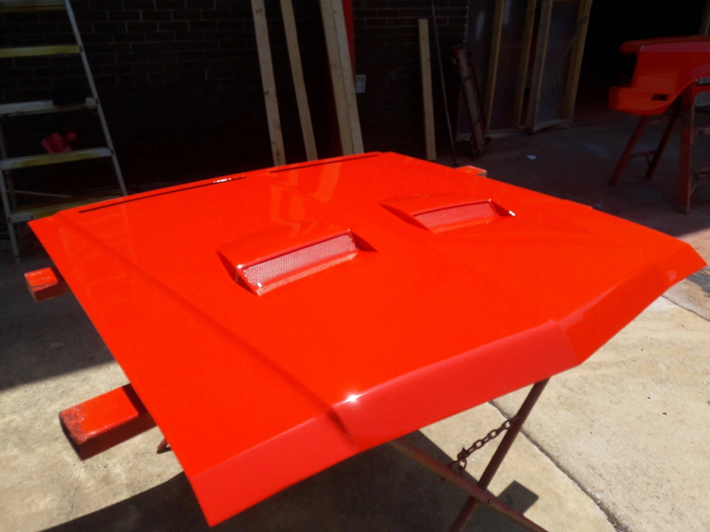

What I am happy with is the way the paint has laid out. Taken into consideration that I was gonna get "foreign contaminants" into my paint as a result of trying to paint it in a garage was fully expected by me,....as for Dave,...he was visibly disappointed.
(It's a freakin' garage,...I don't know what he was expecting)
The problem actually is the exhaust filters plugged. Once they stopped moving air, the supply fans started feeding on them selves, and stated pulling air from inside the garage. Once that started happening, old dust that was just laying around waiting to get messed with decided to jump into the fray.
Just to fck with Dave.
So,..to go on record, so far I'm elated.
What little bit of dust that has found it's way into the paint is only a cut and buff away from perfection. If I could make the red car look good (and it had a terrible paint job) I know I can makes Dave's great paint job look brilliant.
