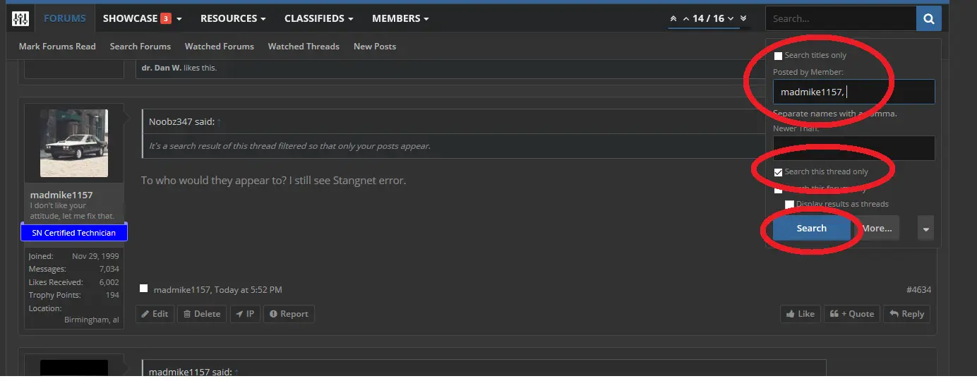

:cool::cool::pFear not however, The detailed post come in VERY handy when rolling backwards and looking through posts to see how or if something was done previously.
As such: That is where THIS little feature comes in handy:
http://www.stangnet.com/mustang-forums/search/24420584/
So keep doing what you're doing Mike. I rib you about long posts but it does make quite a difference in the end. :nice:

That little feature doesn't work for me.....says Stangnet Error.

To who would they appear to? I still see Stangnet error.
