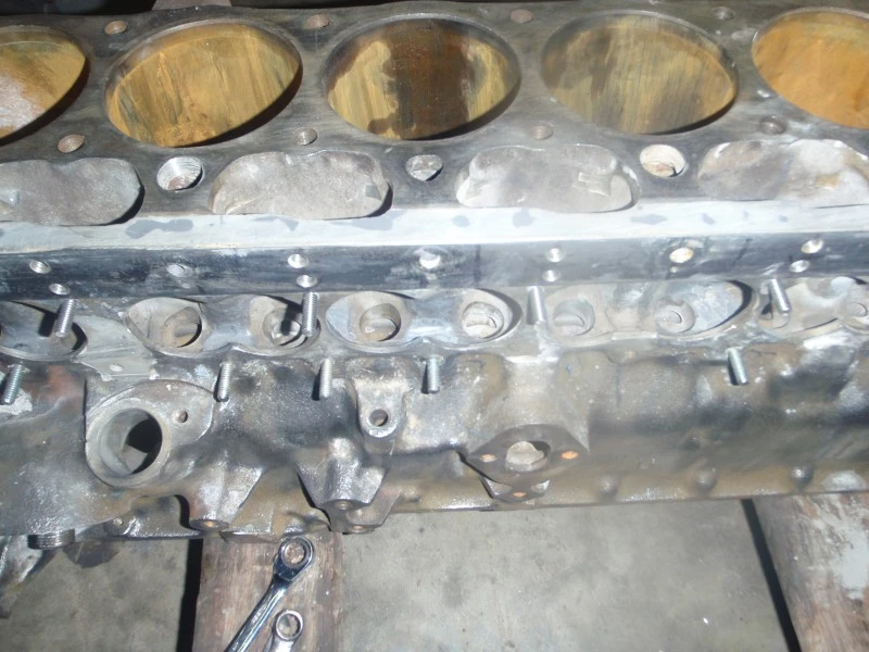

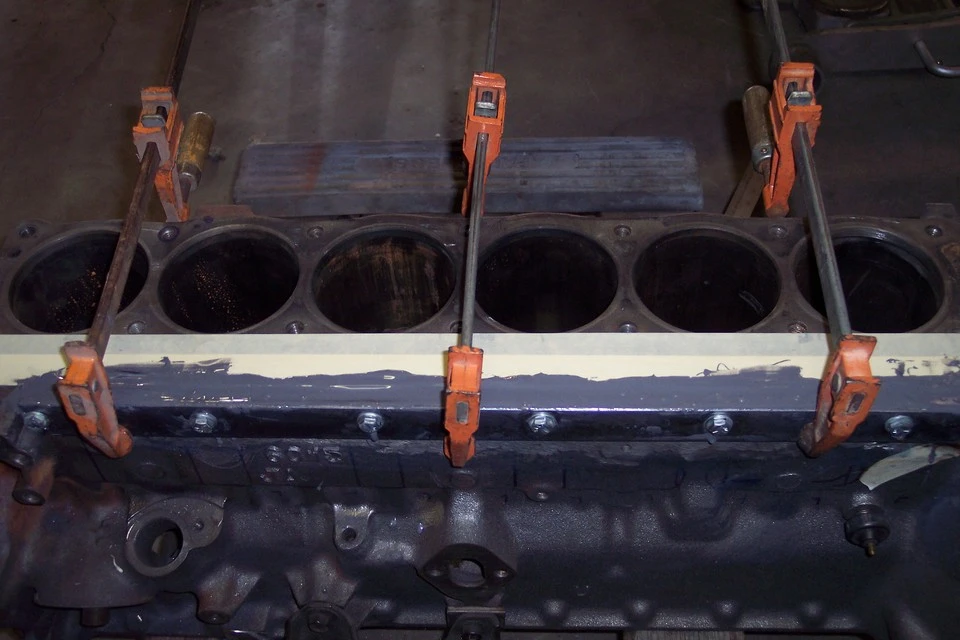

Well,...I could see how you might think that if you didn't know where that "glued on" plate was glued on.
So,...for the sake of being fair.
So now you know. As you look at the bottom pic it's 6 on the left and one on the right.
Not really sure how any oil could leak into the chamber as a result of my glued on plate getting past the stock deck surface that was always left alone as cast from Ford. The pic is still before decking.
and all said and done....I just don't think the plate on the side affects the cylinder seal one little bit.

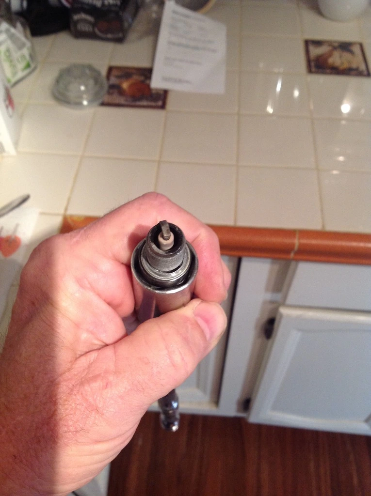

The original #5 moved to another random cylinder,....the suspect cylinder get's it's plug pulled after a 10 minute run up to temp.
Anndd this is what we get:
I don't see no stinkin oil.
How did that happen then? How did the #5 come out of the cylinder so wet that it looked like I dropped it into a pan of oil, and now after running a high vacuum warm-up the plug comes out clean? (well,...what you'd expect it to look like after the engine had been idling).
Can I conclude that engine oil can in fact oooze down the threads of a tightly screwed in spark plug?
I guess the next test is another run around the neighborhood to see if it comes out clean after that.

I've been reading this debacle you're going through. Is it possible that a little oil could've still been around the plug and it got wet while unscrewing it ?
Glad the test turned out well.
I see now how that affects nothing. That being said, why did you really need that plate glued on there? The head really wouldnt stay put without it?

Ive been here from the beginning. Its just been a bit since engine assembly (despite Mike just getting his fingers unglued), and I cant remember any further back than last weekend. I just knew the head gasket covers the top of that plate, and its a thin copper gasket (if I remember that right, cause you put it together last Wednesday I think? @madmike1157 ). So I thought maybe it wasnt perfectly smooth and therefore had a leak due to the plate.

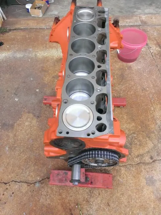

The head overhangs the block. The lifter galley is wider on the Aussie block, hence the need for the plate. I thought that was obvious from the A.B.C. picture gallery I posted this morning.
