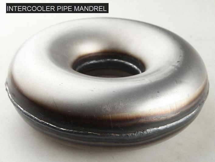

Look at this picture I posted earlier...
See all of the weld spooge oozing out of the center of my cream filled steel donut?
Means that the thing was in two sections, and they welded them together in the middle to make one concentric circle..
Unlike the domestic version that was twice the price, the weld was very prominent,...I figured that I'd use it as a cut line guide to follow along with while using a cutoff wheel on my grinder.
This is what they shipped me...as pictured this morning.
I look at the thing and think..." Cool, they machined the welds down,...now I won't have to grind them down after I cut them in half."

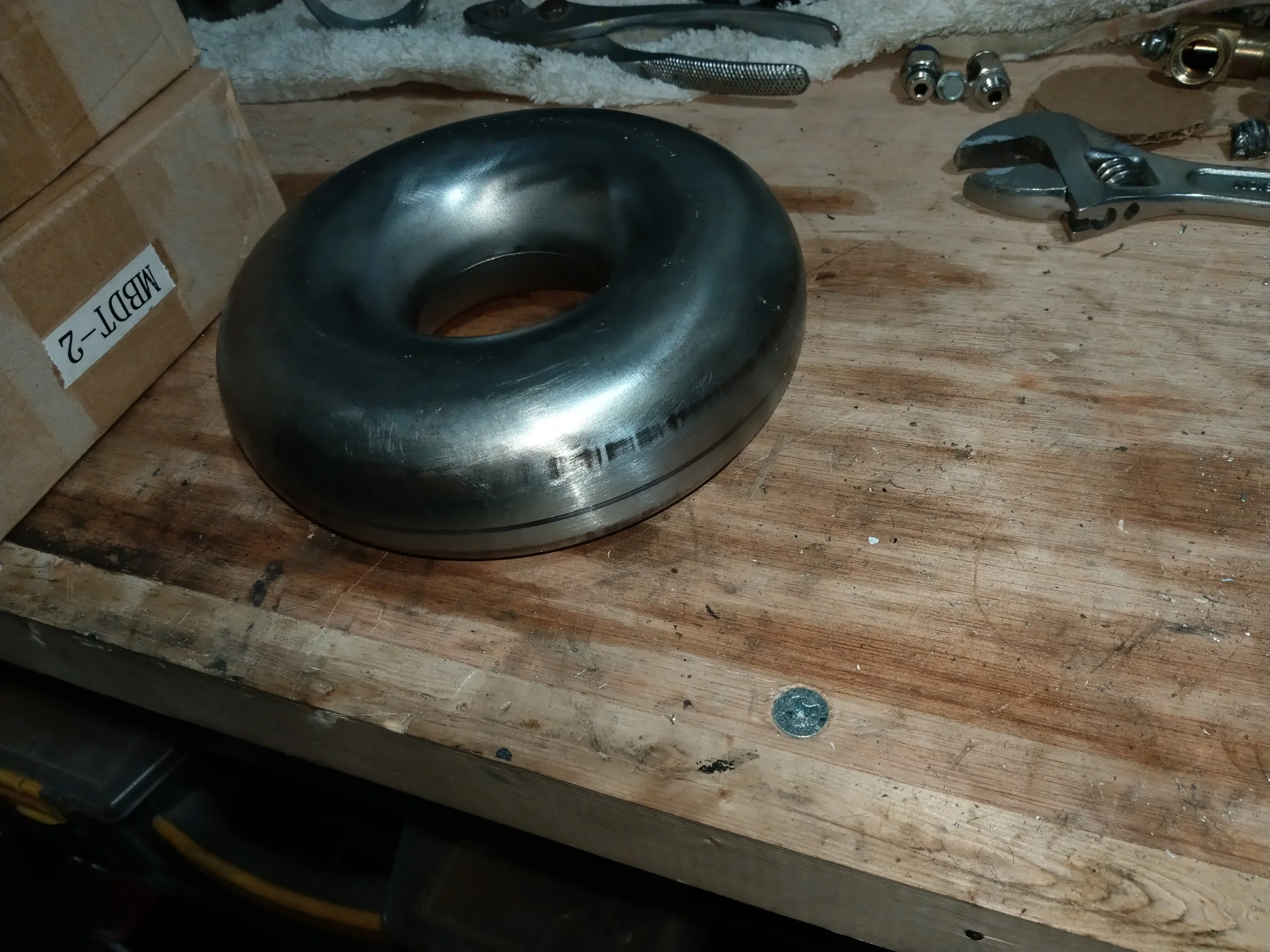

The line you see is dead center,...at lunchtime, I revised that cut line, and raised it up significantly (.500")
I figured by doingn that, it would leave the center to hang lower, and effectively raise the trumpet up 1/4", and give me more room to accurately cut the center weld out. It's the cut to the center that had to be perfect, as it will make up the mating surface to the top of the throttle body..so being able to see that cut line better was the priority.
So, I start cutting...
Get it all completely cut around the outside perimeter, I unclamp the donut out of my vise, and.......
The thing separates into two halfs.
( And I only cut the outside)
The 3rd shift child worker at the Ding Pao Steel donut factory forgot to weld the center...:O_o:..He did it on all three of them....More likely means that the whole run went out that way. The best part is that the mating surface in the center is machined flat...sits perfectly on top of the throttle body.:banana:
I have to section them. They are too wide to sit side by side. From my calculations,... .960" has to come off each side of the donuts.
Let's think this through...
TB spacing is 4.08 c-to-c. That makes it 2.04" to center between them.
The donut halfs are 6" in diameter .....means .96" has to be removed from each donut so they'll meet up in the middle and still be centered over the TB hole. Measured from the outside.
The bigger problem is how in the hell to make that mark, and how to square up a circle so I can cut a right angle cut down the side,......of a circle,....that's convex. With the tools I got.:shrug:

That is the plan. After they section all together, I plan to weld them together to form the floor of the box. I plan to fab up a way to run a bolt through to the plate that the TB's are mounted on that'll hold the bell mouths tightly against the throttle bodies, and use a piece of silicone tubing that will act as a gasket, or collar to seal them together.
Then I have to figure a way to make the box top removable from the base so that it will be easily done, and also seal the TBs from dirt and dust.
Just a few of the things I gotta do.
Mike you could make a jig.
Knowing the c-c of the TB make a square jig out of what ever you have lying around, wood could be used and even shaped if needed so that the jig fit snugly against the piece. Draw your lines on each side of the jig and cut.
As enterprising as you are even a thin sheet metal plate with a piece of tubing that fit snugly into the center of the donut could be used as the jig, this would give you a easily defined center.

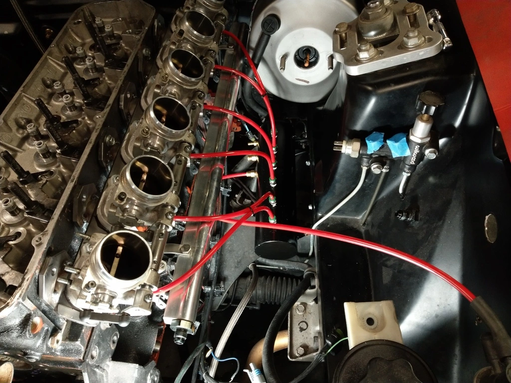

I have a strong concept in mind. It'll look everybit as good as the old intake did. I think that there'll be enough of the TB's Exposed so as to not need to do any 70's era clear acrylic stuff, although the trumpets should turn out to look pretty cool, but will be entombed in that welded together box.
