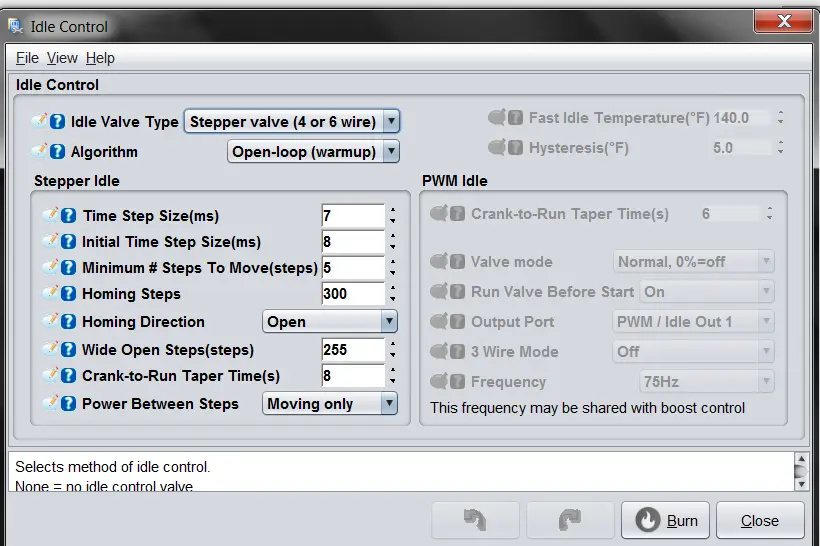

- true iac or a warmup valve
- have you tried unplugging the iac to see what happens.
- verified that the TB is not stuck open some.
If nothing happens with the iac unplugged then it's not the idle settings.I can give you the tune, can't get a log for the above reasons, though I haven't gotten the datalog to work for **** anyways.
Nothing happens with the IAC unplugged. I've gone while the car is running and physically shut the TB by hand. It idles down to probably 1500 all the way against the throttle stop.

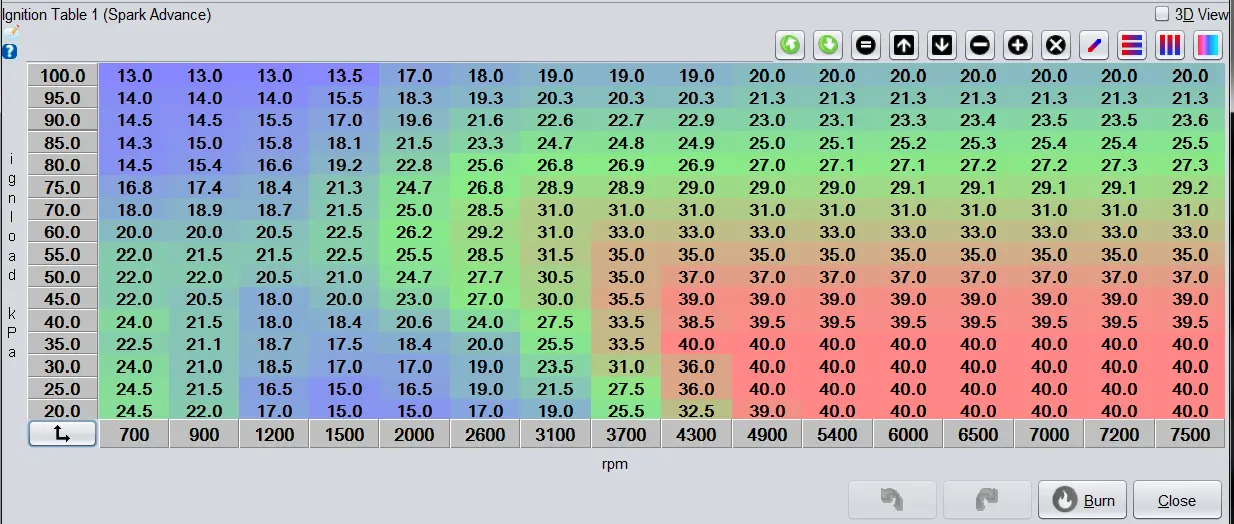

With what you have described I think it either has to be a mechanical failure (cracked intake) or you have too much timing in the engine at idle. Timing REALLY affects idle speed.

Nothing changed with th IAC unplugged though dropping the warmup duty from 90 down into the 50s seemed to lower it. I could have just been hearing what I wanted to though. I kept screwing with IAC settings and looking through Ms forum posts but wouldn't start at all towards the end. Think the battery ate it.

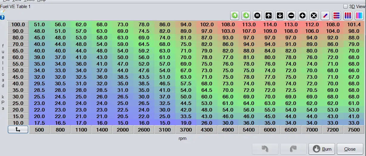

I'll post the timing table and msq here shortly.

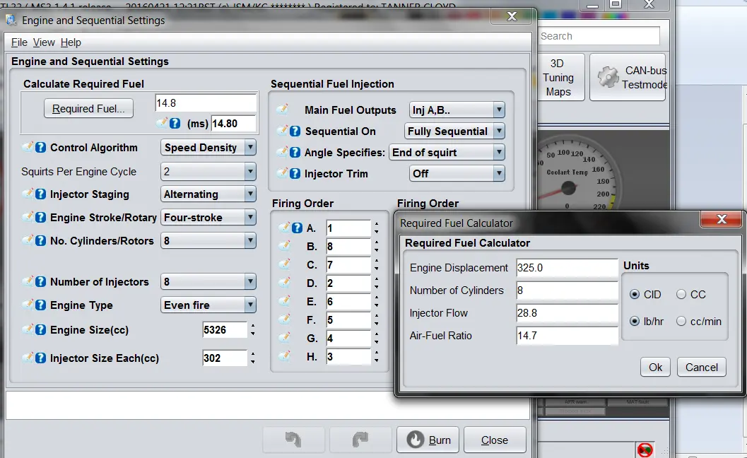

It's literally just the tune they emailed me with the injector size and cubic inch changed. Tried to eliminate as many variables as possible. They sent me a stock 4.8 tune and an "ls1 big cam" tune.

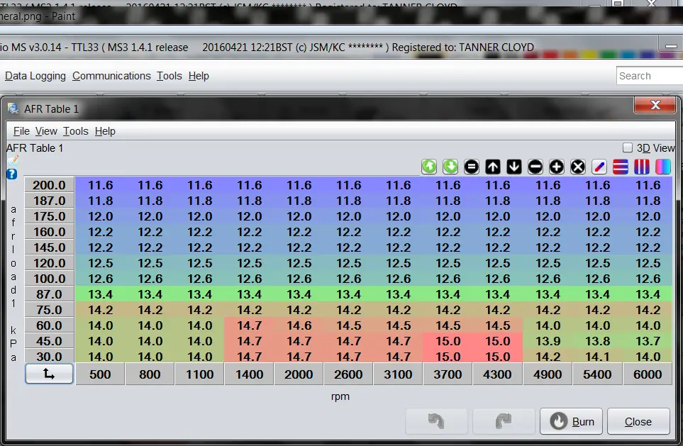

You put much faith in wideband readings at idle? Always seemed inaccurate to meTry this tune out. All I did was tweak some of the tables and settings for you. they have implemented a new idle fuel strategy, I will need a datalog and AFR reading from the car before I can adjust the fuel tables.
I give wideband readings at idle little-to-no value usually there about two points off on the lean side. I adjust fuel at idle until the car feels good and starts making more vacuum. However being that I'm hundreds of miles away on the other end of an electronic device. it's the only viable information that I can use. I need the AFR readings for quite a few things the datalog will show me vacuum and whether or not the idle is oscillatingYou put much faith in wideband readings at idle? Always seemed inaccurate to me

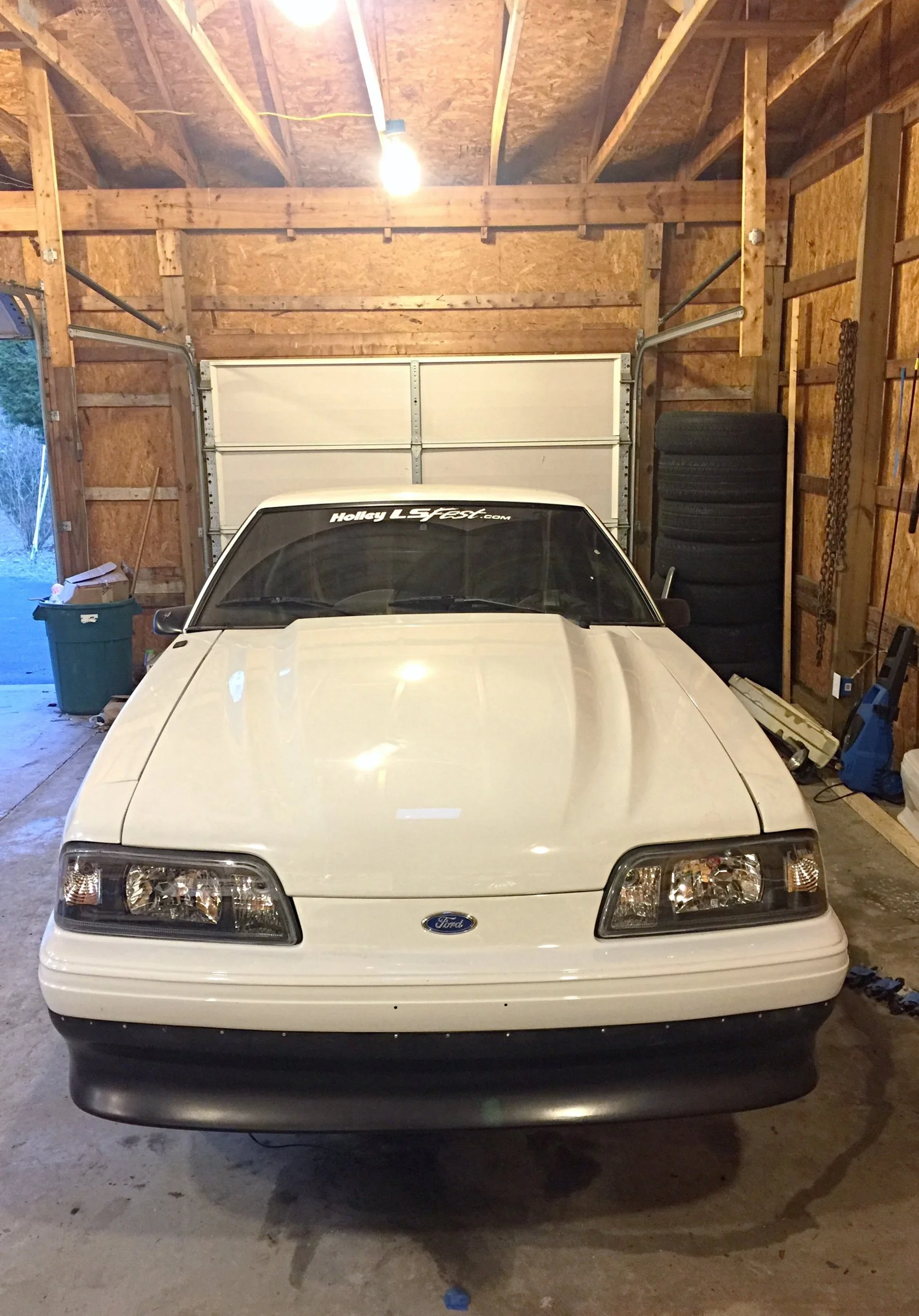

The day hell freezes over and it actually moves under power.When will we see passes in this thing?
Joe
I thgouht you said the car hasn't seen the light of day? Then, how did a bird crap on your mirror then....?
