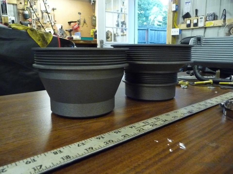

Meanwhile, I got the SCT chip installed and the PLX module for the boost gauge. Still waiting on the injectors but the 933-4FA018-022 crank pulley came in. I was wondering what the depth dimensions were before I ordered it but I could not find them online. So, here they are.

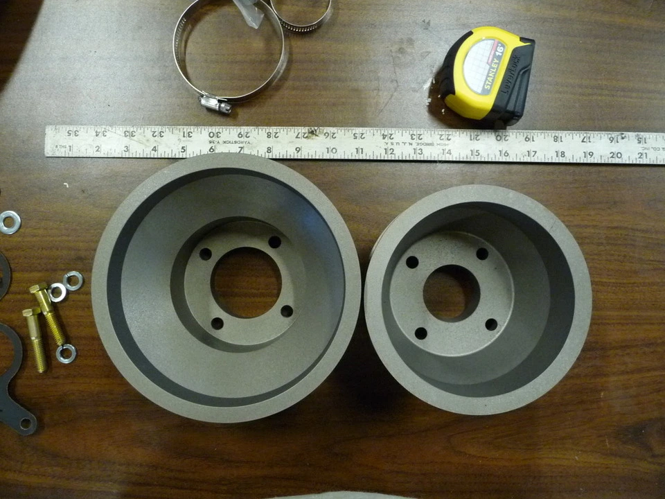

The stock pulley is only slightly shallower by about 3/16".
The diameter is obviously bigger and should yield some extra boost.

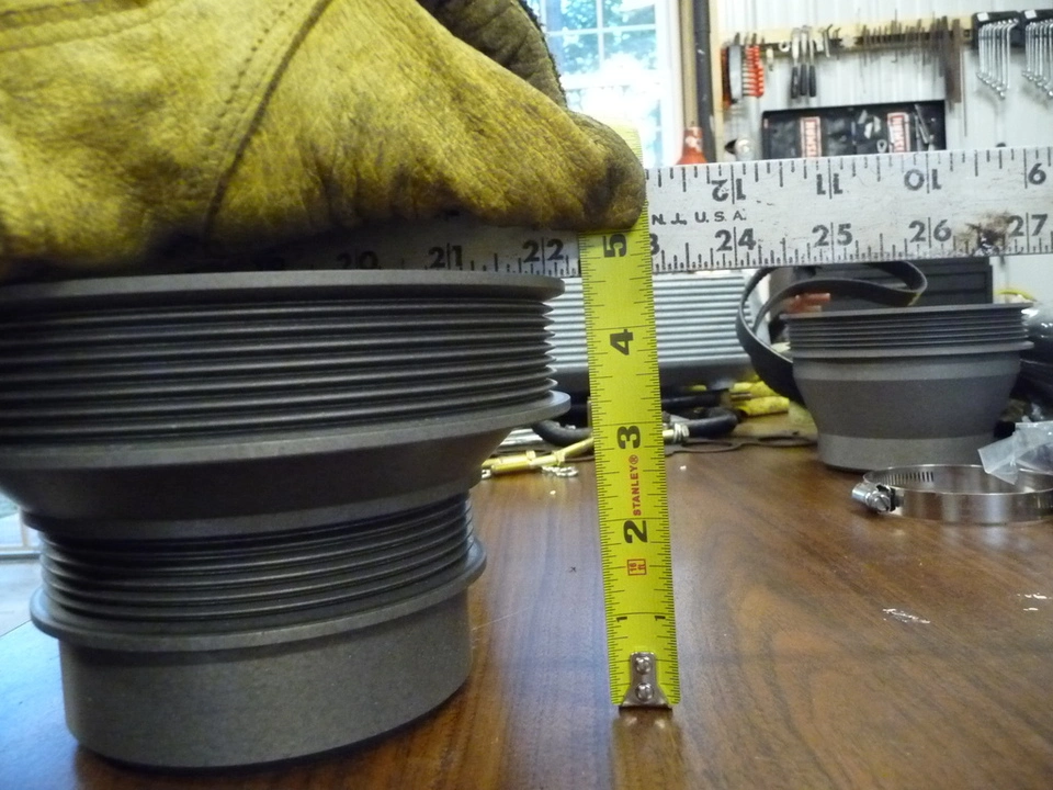

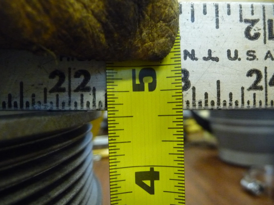

Overall height of the 933-4FA018-022 is 4 9/16".
Close up
