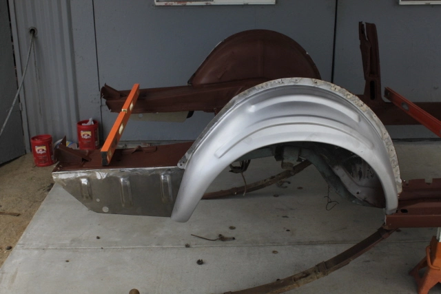

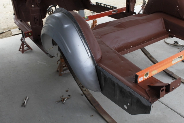

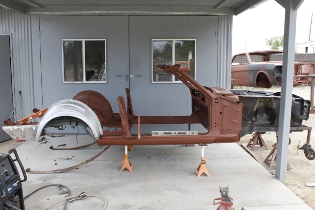

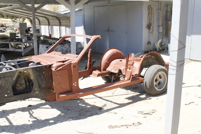

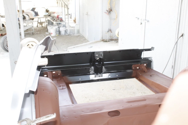

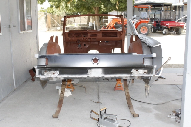

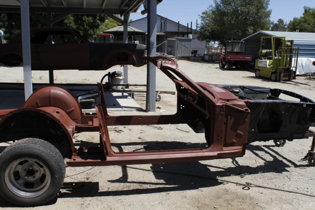

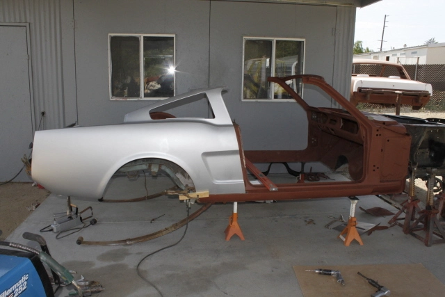

i got it leveled and squared up, it wasn't to hard to do it was pretty close already. i managed to get the outer wheel tubs and trunk drop offs in. i could have gone a lot farther if i had the panels.good news is the panels are on the way from Dynacorn and should be here start of next week.
i got to use my new saw . GO GET ONE, this is the best saw i ever owned. i over lapped the trunk drop offs and sawed through both pieces at the same time so i could butt weld them in. the only thing you will not like is it cuts to fast. i give it an A+

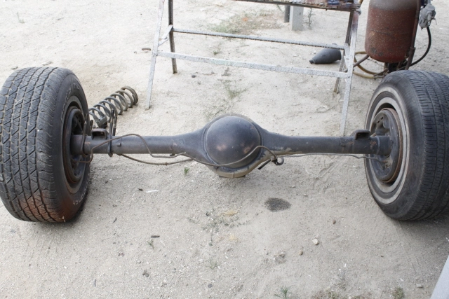

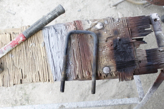

i had to take out the rear end because it was causing the rear half to sag, it looks like a dodge rear end? its about 2 inches wider than the ford. i don't know why they even used it? the u bolts are square
