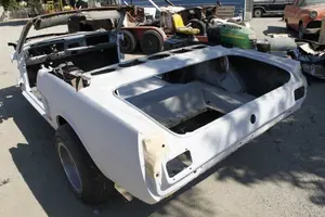

actually i will be doing two at the same time this time ,this one is mine .it is a 66 C code -289 2v.
a stang net member needed patch panels so i went ahead and removed the roof ,it was just easier that way. this one needs a floor and outer wheel tubs but every thing else is solid.
the other is a 66 i think ,and belongs to a friend .he has already done some sheet metal replacement so i am not real sure what i will still need to replace on it. two at the same time should not be a big deal ,i will do a part on one then move to the other and do the same piece
so the measurements will stay clear in my head:crazy: he is supposed to bring it out monday.

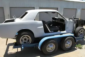

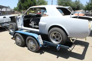

the only problem i see right now is a lot of the Dynacorn metal is on back order and no one can say when it will be available,not long i hope. Edit ..I found a couple of before pics ,this is how it looked before i started cutting it apart .
i started cutting my coupe apart. my friend hasn't brought his by yet.

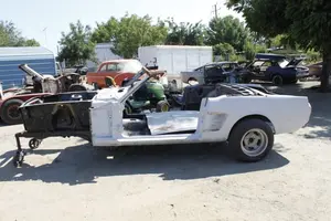

i cut out the back window area ,the tail panel and trunk brace , and the driver quarter ,just to hottttt! it actualy rained this morning .just enough to make it steamy :drool: . i left the inner quarter brace to the wheel tub just to keep the door jamb in line because i have the doors off. i will need the doors to fit up to the small piece of the quarter that is left on the door jamb before i finnish trimming all the little pieces of sheet metal that are left over .
floors are rusted so i am replacing the entire thing along with new floor supports, it sat for a while with the windows down and the carpet still in. the trunk floors are in good shape. i will be adding front torque boxes with the new floor. frame rails are in very good shape .
i trimmed off the other quarter panel today and the other pieces that were left on the inner wheel tubs. i think i am going to sand blast the whole inside of the car this time before replacing any panels .it will be easier to do with the roof off . i have a set of original doors on the way . i will fit them to the door jambs before trimming of the last pieces of the quarters. i still have a little bit of trimming to do at the top of the windshield frame.
