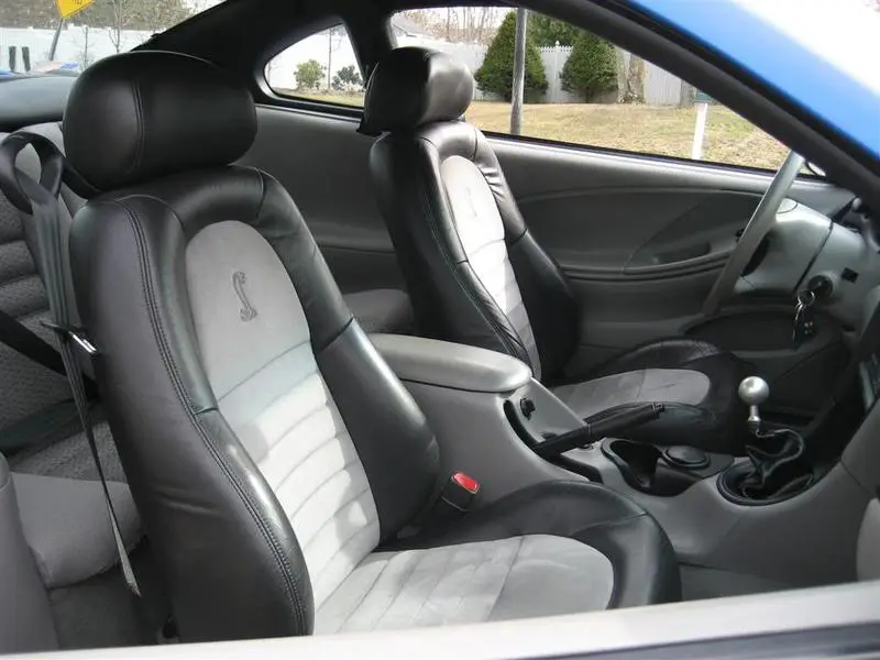

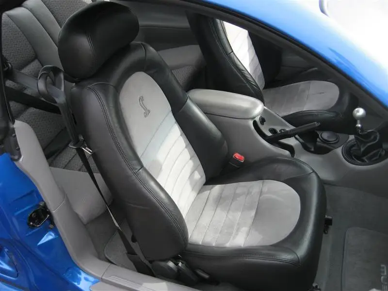

As promised, here are the pics. I only got a quick ride in them since I completed the install and so far so good. Going out right now and see how they are in the twisties :).
Damn those look good!!! :nice: I actually like the cobra emblem in the seats personally. Those seats work really well with our color of interior. Was the installation hard for the driver seat?
Thanks. Not too bad Silver to get the driver's side going. I had some trouble initially when I first wired them up as they came undone when I temp put the seat in place and thought I had connected them up wrong, but figured that out soon enough. I with you in that the Cobra emblems don't bother me as well.
